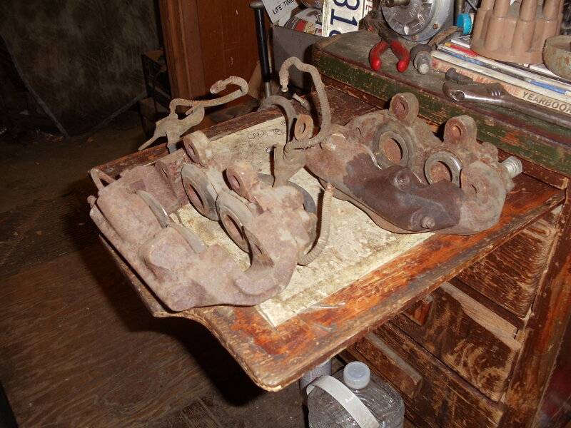

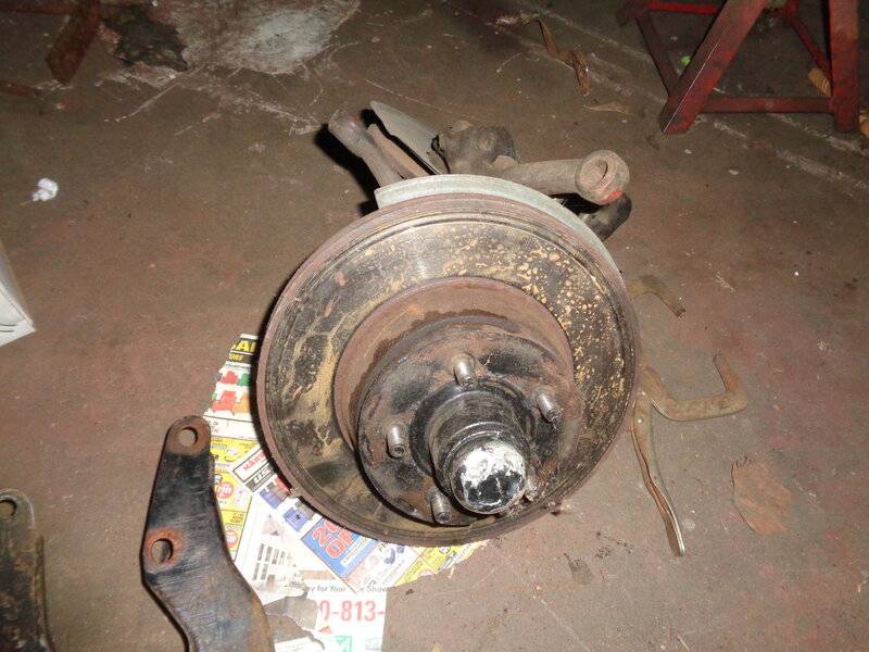

I'm pretty sure those Cragars work with factory disk brakes. So you could buy a 67-72 Kelsey-Hays set-up from a seller on FABO — I see them pretty often. This has the advantage of being all Mopar OEM and you can find replacement parts for it under "69 Dart w/ factory disc brakes".
Factory Kelsey Hayes 4 piston caliper brakes fit just fine.
I agree with mvh and RRR. The factory Kelsey hayes disc brakes 4" bolt pattern will work fine with crager SS wheels. Excellent choice, I love the look by the way.

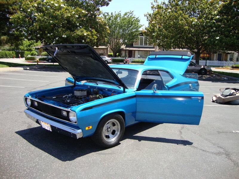

kh stock disc brake stuff 65-72 a body or we did 14's on a ssbc kit on this duster with 10'' drums , but had to glue the weights in a area were the caliper didn't hit the weights . but it was 14x7 u.s. indy slotted mags

I'll have an all there, 100% complete, Rebuilt disc brake set up for the 65-72 cars, next week sometime.
Waiting on some parts to finish it up.
Keep your eye on the for sale section, if your still interested.
