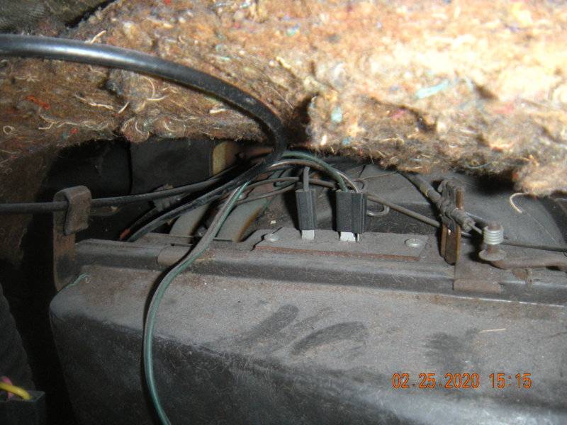

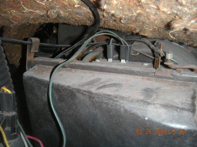

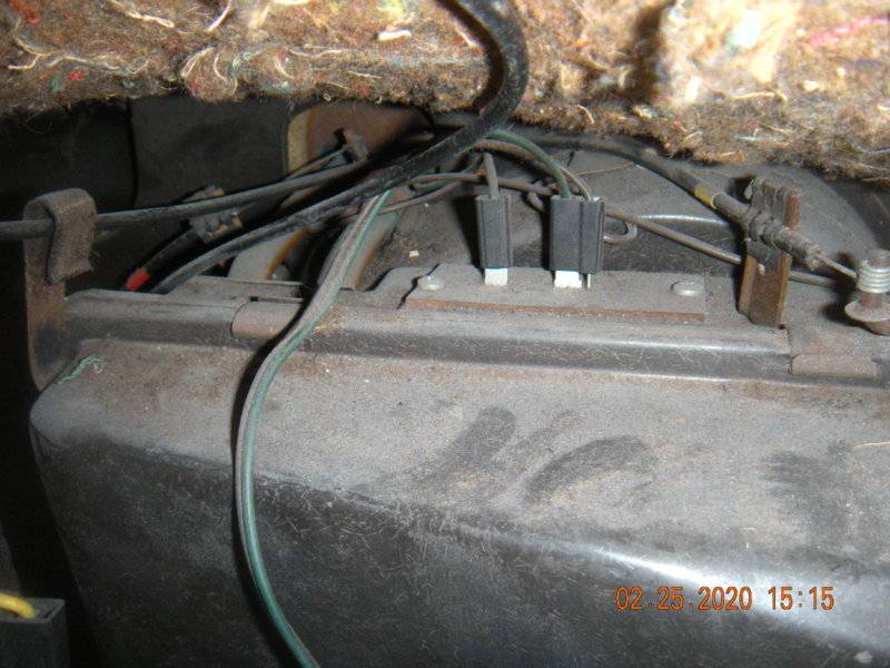

Mar 3, 2020 #28 Kendog 170 Let the boy go ! Joined Mar 10, 2016 Messages 5,697 Reaction score 5,689 Location Reading Ma. Blue arrows are some of the clips. Red arrow is the hold down screw for heater core. If you blow thru the heater hoses and remove coolant from core it will spare you a mess inside the car. Good luck.It's suppose to be 50' on Sunday.
