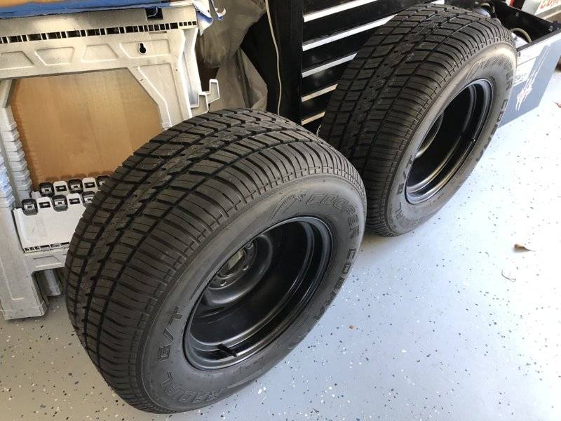

Here is the original post
1/4" spacer 275/60

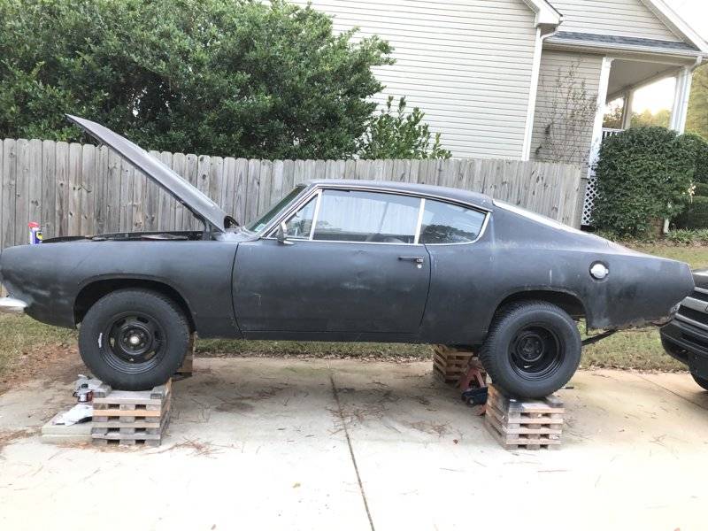

Here’s what the 275/60/15 look on a set of 15x9’s with a 4.5” backspace. I have an 8.8 rear with the 1/2” doctor diff spring relocation I know it’s a barracuda. But just to give some ideas.
