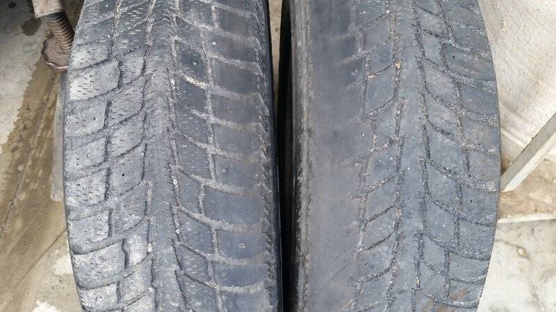

Hi Folks
Last November I put on the snows......No strange wear patterns. We put about 2000 miles. Fast forward to today, upon removing them I found the inner edges of the front tires literally destroyed. I slapped a string line on them parallel to the rear rims and found that I had 3/8 inch toe out over a 14 inch rim.
Back story.......I did front wheel bearings and lower ball joints the summer before and put about 4000 miles on new tires and saw no wear issues on the summer tires.
Looked under the vehicle while my wife worked the steering wheel back and forth and found no unusual slop in the tie rods. The steering wheel feels great.
Any suggestions as to how things got this out of shape? We live in the country and the roads are not the best in the winter/spring......But to knock it out that much????
Thanks for any input or suggestions.

I initially thought that as well. I would think that I could tell that the camber was insanely negative enough to cause this type of damage in 2000 miles just by looking at it. I can see 1/2 degree negative camber on my Demon.
I could also see that the toe was way out as well when I started looking.
Using my method (which hopefully will get me to an alignment shop to confirm with out any tire damage) (and I agree that it is taking a lot for granted with regards to the rear wheels as a reference point) to get it set right. I am just trying to ascertain what happened in the last 2000 miles to cause this. Like I said, the roads are super shitty around here, but for the most part I am very gentle when I drive, but I can't miss them all. :(
I don't hear any clunks, creeks or groans and everything appears tight.
Here are a couple of pics. One set is what they looked like 2000 miles ago, and the other set are what I took off the front today. The tread feels sharp as I move my hand towards the worn section on the shitty set.
3/8” toe out is a TON. That will wipe out the inside edge of the tires very quickly.
I run over -1° of camber and don’t see any significant camber wear over the life of my tires. To wipe out the inner edge in 2k miles you’d need a LOT of negative camber, it would be easily visible. Like it would look broken.
If the toe out measurement is accurate that means your toe changed by more than 3/8” somewhere in that 2000 miles. I’d get that thing in the air and make sure nothing is bent, broken or loose before driving it anywhere.
Echoing 72BluNBlu. Looks like a combination of toe and camber.
I'd run a string taught on two jack stands down one side, parallel (with a tape measure) to the door/rocker about a foot high and as close to the tire bulges as possible, and look at both the front and rear on each side with the steering wheel centered. I'm guessing you can get another gentle, slow 50 miles before the cords show. If you are not sure you will make it, move the rears forward, same side and plan on getting a set.

Thanks for the input everyone. I am planning on taking it to a shop to have it checked and set. My cursory checks showed that everything appears tight and not bent. After correcting the toe out, the car handles fine with no noises or handling anomalies. Car tracks dead straight on the pavement with zero steering wheel input.
The only thing that this car was ever exposed to are the shitty roads here in Northern Ontario. The tires are 10 years old and the car has never had an alignment in the 20 years that I have owned it.......I have never seen wear like this from this vehicle the whole time I have owned it or it would have gotten an alignment check.
Thanks FABO
So......In the shop today. Tech found no mechanical issues whatsoever so he set it up for alignment. Camber and caster were spot on as were the rear measurements. After my crude measurement/adjustment technique, a little more toe in than spec. was recorded. He adjusted the toe and the car handles great. Will keep a closer eye on the tires of all my vehicles from now on. Just glad that I am safe.
