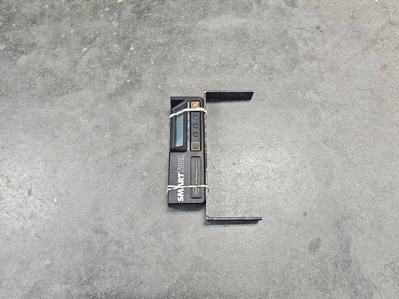

Random assortment of stuff I have used and still use.

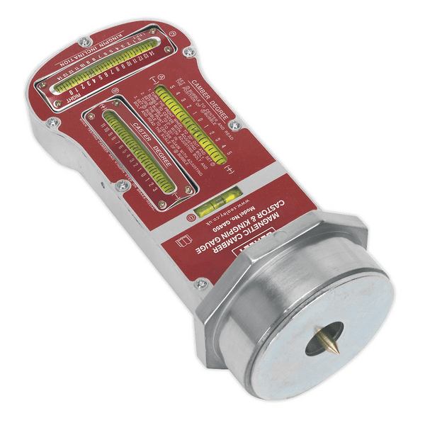

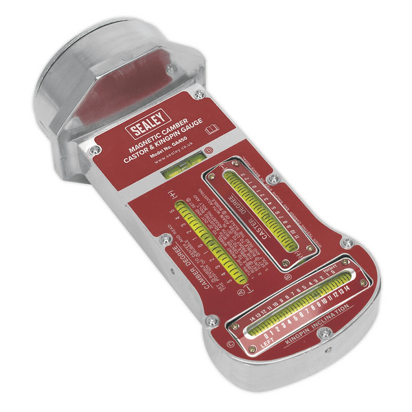

One thing I've noticed in all of the newer gauges posted on this thread is that the lack the spring-loaded needle-like pin that sticks out of the mounting surface, and is used to locate the center of the axle:
I always thought that ensuring concentricity was important to getting accurate measurements.
Is there a different way that those other gauges do that?

My old Ammco has no such centering device
Thanks,
– Eric
For camber the gauge just has to be parallel to the face of the wheel, the angle is the same across the whole plane so it can be anywhere you can get the gauge parallel to the wheel face.
For caster, because you're actually subtracting two different camber readings, you end up canceling out any input you might get from not being centered because the gauge is staying the same distance from the axis.
The centering pin, I believe, probably has more to do with making it hard for the gauge to move around during the measurement. An extra safety on the magnetic attachment. One of those nice things to have that isn't essential that has likely been deleted for cost. I'm just thinking out loud though.
