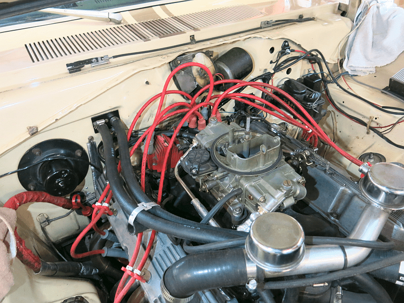

Just reread the title, here my set with aluminum covers, a combo of the MSD holders and accel one that mount to the vc bolts
Yeah the nice part is you have the lower flanges, mine are top mounted so the bolt is to high for that. But I have temporarily have a solution unit I find what I want for the long term.
