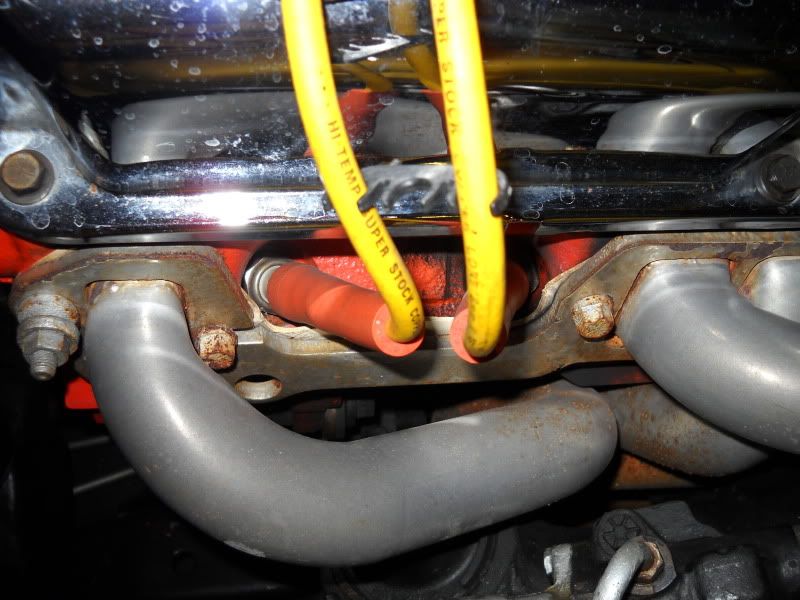

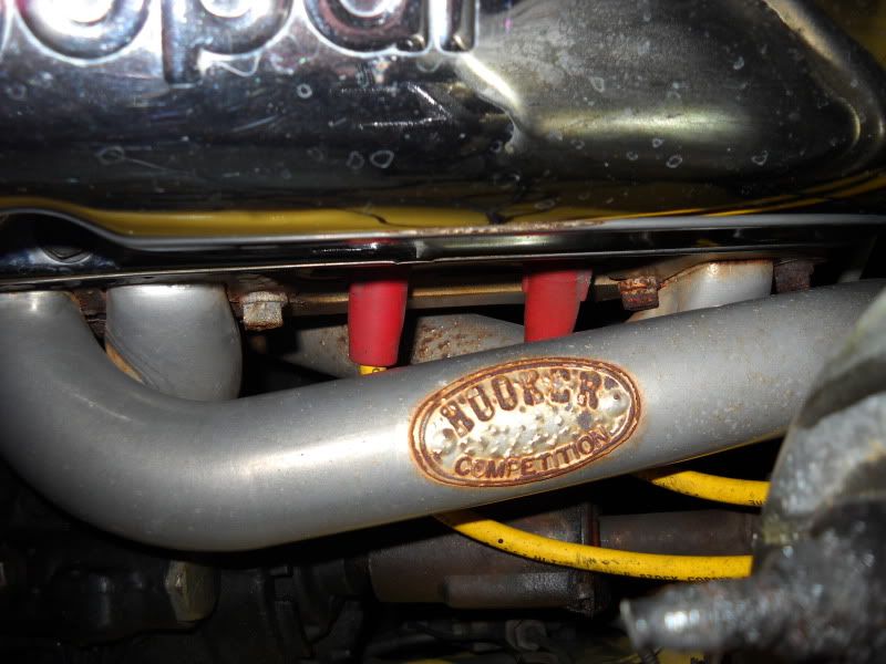

I have accel wires that came in a kit w both 90 degree ends and straight ends I used two of the 90 degree ends on the back two plugs on he drivers side and then used looms to bring them up to the cap w/o touhing the header. hope this helps.
Use 90 degree ends on the 2 back left wires (#s 5 & 7) and straight ends on all others.
Route 5 & 7 across the firewall and drop them down above the steering shaft and then to the plugs.
Please excuse the crud, it has taken 9 years to get that look.
Cylinders 1 & 3
Cylinders 5 & 7
5 & 7 Routing
Very useful Yellowdartdave! However it appears that the yellow part of the wire is still hitting (or very close too) the headers. I take it that hasn't been a issue?

The # 7 wire is about 1 and 1/2 inch from the pipe and I put those wires and car together over 8 years ago.
