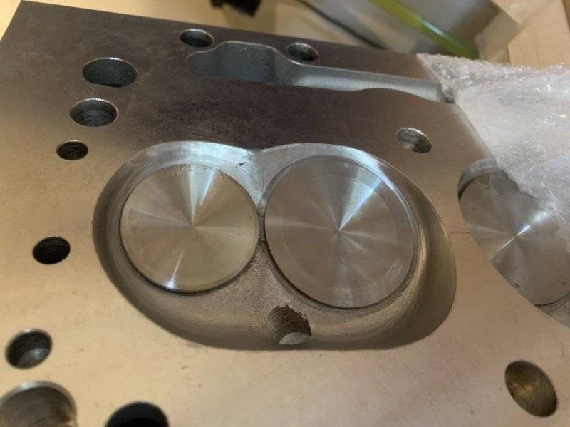

I have a set of the CNC'd Speedmaster heads. I cc'd the chamber and came up with 75 cc's. Seems a bit big but I'm sure of my measurement. Anyone else cc'd their heads yet?

I CC'd mine last week. I got 65cc in multiple chambers.
edit: I also CC'd a pair of intake ports after I got the heads back together, 188cc.
Please specify if you guys checked a CNC chamber or an as-cast chamber. The CNC ports have been delivered both ways, according to other threads. I think bare CNC version was an untouched as-cast chamber and the assembled CNC version had the chamber CNC cut as well. So the sizes may be different.
Sorry, I covered all that when I posted in the AM inspection thread and didn't think to post it all again.
The numbers for the as cast head are probably accurate.
The assembled CNC heads all come with no chamber work, and are list as 68cc. That's inaccurate. I measured them and They have the same 65cc chamber as the unported heads. The runner volume is accurate at 188cc as measured.
The bare CNC heads come with a CNC chamber, there's only one person I know of for sure that has those, and he hasn't posted any data.
I will try to get mine roughly measured this weekend. Mine came as fully assembled CNC ports but they do also have CNC chambers as well.

The boxes and the invoice for mine have them matching, with part number PCE281.2151. I did order them for hydraulic roller application. In reality, I would have preferred them without the chamber work, since they leave a sharp edge between the valves.
Maybe since they had so many orders they started sending these out to fill those orders. I did order later than others. I think I placed mine late Monday, toward the end of the sale.

Update:
I cc'd my chambers again and got 68 cc's. The chamber is CNC as well as the ports. I found out why I got 75 cc's on when I did it the first time. The fluid I was using was leaking past the exhaust valve. WTF! For the 2nd time I sealed the valve seat with vasoline and got the 68 cc's for CNC's chamber.
I saw one close up pic of the CNC chambered version....... I didn’t care for what was left of the valve job after the CNC work was done.
The seats in the one I was looking at needed some attention IMO.
