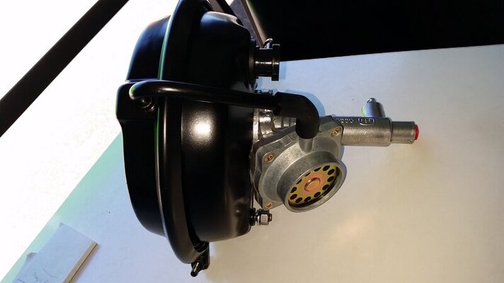

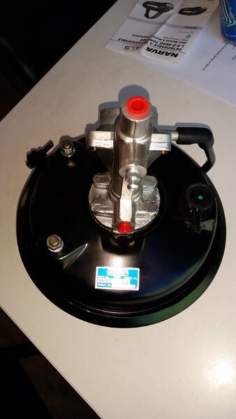

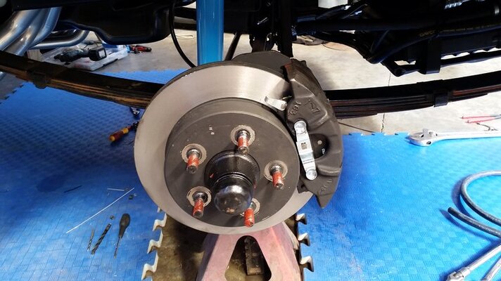

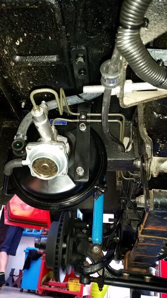

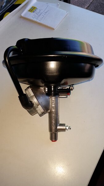

If you do decide to go with a booster, you could use a remote vacuum booster like I used on my A100.
Makes me feel better about stopping now.....4-wheel drums were OK for a couple of hits, then hard to stop after that until they cooled again. And before anyone says anything, they were set up properly and there was nothing else we could get out of the effectiveness.
