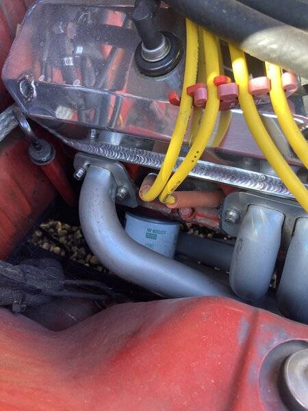

All the bolt holes were drilled about 1/4" too low and cause a decent port misalignment.
And you're right, looks like these headers were designed with 273/318 manifold ports or thereabouts.
It all works okay but who wants to settle for that.

Look what happens if I line up the ports on these Sunday night rebuild gaskets. Fixable but annoying.
Those look like the Fel-Pro ones for cast iron manifolds. I have a pile of them as they are what comes in the whole engine gasket kits.
They seal great on manifolds that are flat, but do not work on headers very well.
I have had good luck with the factory Hooker. MR.Gasket and some other white one's. The Fel-Pro ones were fine. The Edlebrock worked well too.
Clean and Flat is key and most will work fine.
In fact that I use the white ones to mark cast iron manifolds i port.

I'm considering clamping the header flange to my drill press and end milling the bolt holes to elongate them. Rat tail filing would take forever
A carbide burr in a die grinder works to elongate too
