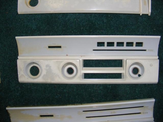

closer shot of the a/c bezel

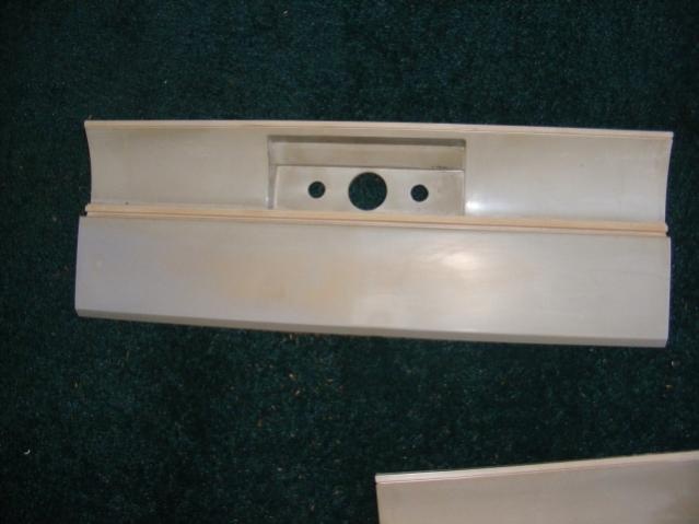

glovebox

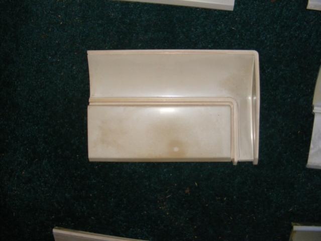

and end panel
