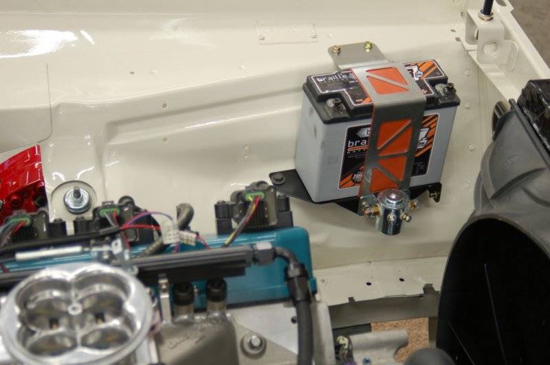

I got the coolant recovery reservoir mounted by the radiator and installed the battery box and battery. The list of things that need attention is shrinking.

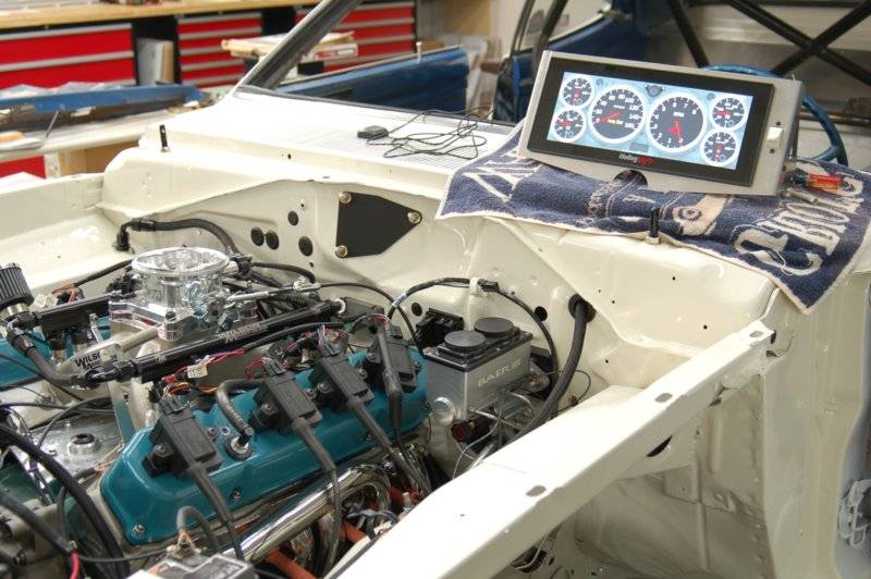

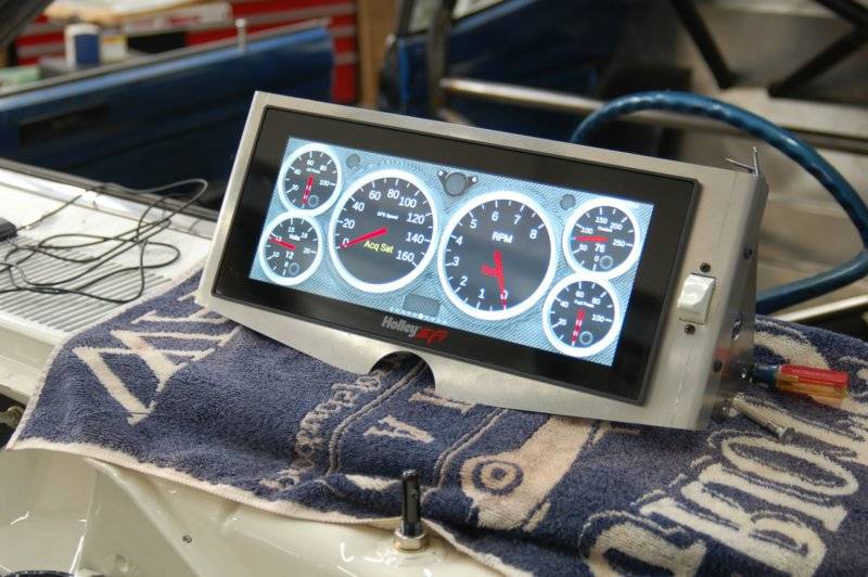

I have the Holley Pro Dash up and running. Just sitting on the cowl at the moment while I double check everything. I need to send the housing bracket out for powder coating and then get the screen mounted into position. I keep plugging along. Took some time off during the summer but now I'm back working on the Duster.
Andy, I am thinking about the Holley Sniper for another project. I am curious as to how it controls timing, and what hardware you need to go along with it. I currently have a stock Chrysler ignition, but I also have an MSD Pro Billet distributor and 6A module, new in the box. I know you have gone a different direction with your project, but I figure you must have a pretty good understanding of how it works to do that.
Sell your MSD distributor and use the money to buy a Holley Hyperspark distributor. Then it is plug and play to control timing. You can use your 6A module or sell it and buy the Hyperspark ignition box. Either should work, just depends on your preference.
Thanks Andy. Does it just control centrifugal advance, or does it provide a type of vacuum advance as well?
It is complete timing control. Start retard, high speed retard, rev limiter, vacuum advance, centrifugal advance, whatever you want.
If you're thinking about buying a Sniper you should download the instructions from the Holley website and read thru them a few times. That will help you understand the capabilities. The Sniper has full data logging capability that most people don't even know about. You can record your 1/4 runs and then play them back and watch all of the engine parameters. You get a lot of capability for $1000 with the Sniper.
I read an article about their distributor last night. I also watched a video about converting my MSD to work with a Fitech. Now I know where you were coming from with your recommendation. No comparison for the simplicity of set up. I love that cap fixture for indexing the distributor.
Yeah the MSD distributor is a bad match for EFI. It can be made to kind of work but it takes a bunch of effort and it requires some expert knowledge and even then it doesn't work really well. My advice is to sell the MSD to an old school guy who has a carb and move on. The Hyperspark distributor should be plug and play.
