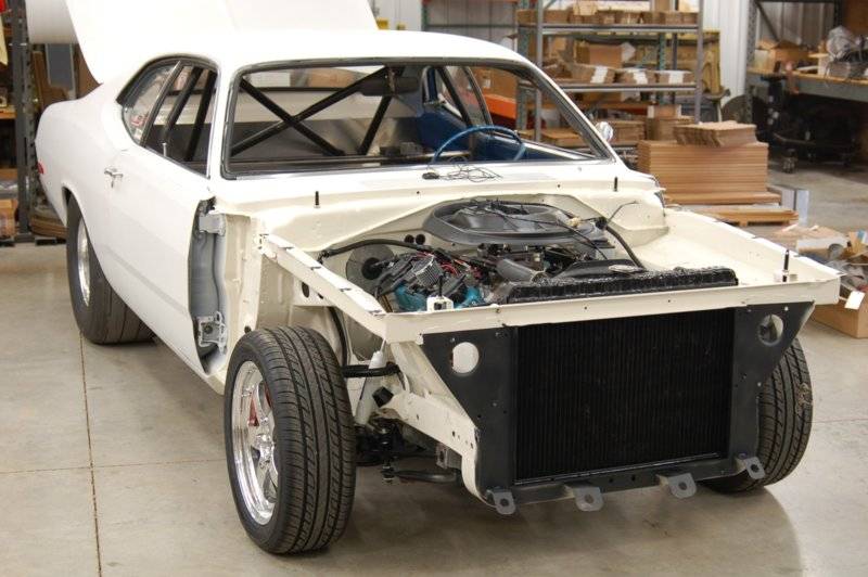

I've been working on putting the front sheet metal back on the car. Had to take it apart and put it together a few times before everything lined up properly. Not sure how they built these cars in an hour on the assembly line! It takes me 20 hours just to hang the front sheet metal.

I figured out that I had to to put the rivnuts on the top of the spoiler so the screws could be accessed from below. The first time I put it together I had the rivnuts in the brackets and the screws came in from the top. But with the spoiler on I couldn't install the bumper. And with the bumper on I couldn't install the spoiler. Stuff you figure out the hard way......

I have a spoiler by Randy but the design he has for the mounts is super flimsy. I figured that it would tear off the car and I'd drive over it the first time I hit 100mph. So I welded four tabs to the lower radiator support. Now the spoiler mounts to the four tabs and the spoiler is very rigid. The trick is that the bolts have to go in from the bottom since once the grille is in and the bumper is on you can't access the space above the spoiler.

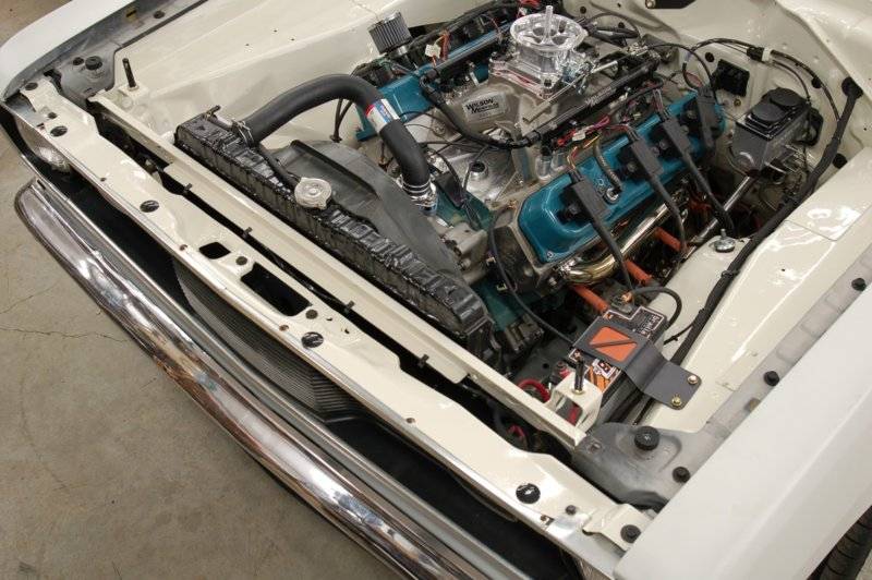

I finished up the majority of the front sheet metal assembly. I had to do some fab work in the grill support area due to the custom core support in the car. But I think it all came out pretty good in the end.
