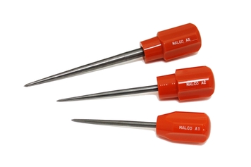

If you can get the coupler on far enough to expose the shaft groove, you can work an awl into the cross pin hole and "pull" the coupler rest of way......
