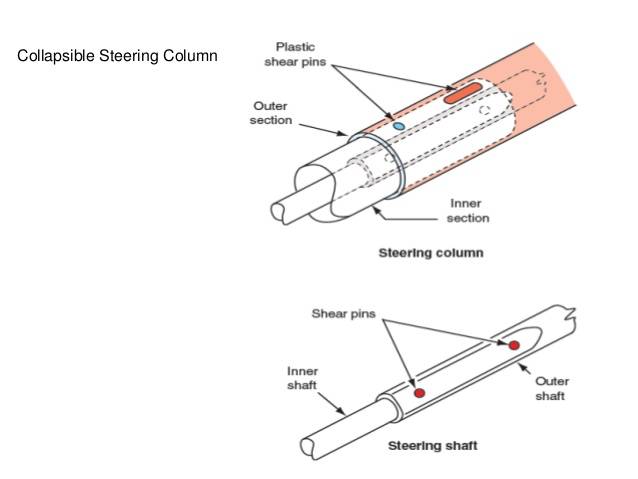

I think my steering shaft did collapse somehow, how does it collapse and how is it rectified? It is a manual and staying a manual for now.
I'd have to vise the shaft as the column is out of the car. What keeps it in place? So it doesnt collapse again while driving? And what would've caused it to collapse?
The only thing that keeps them collapsed, or un-collapsed, is a little friction between the inner and outer shafts. From the factory, 50 years ago, there was some sort of plastic melted inside. Sometimes called "shear pins". So that plastic has either broken, or just isn't holding on anymore. Very common thing. The shaft should still have some friction holding it in place. They don't collapse all by themselves. Once you get it back to the correct length, it shouldn't be a problem. The old Mopar steering shaft is basically designed like the bottom illustration.
