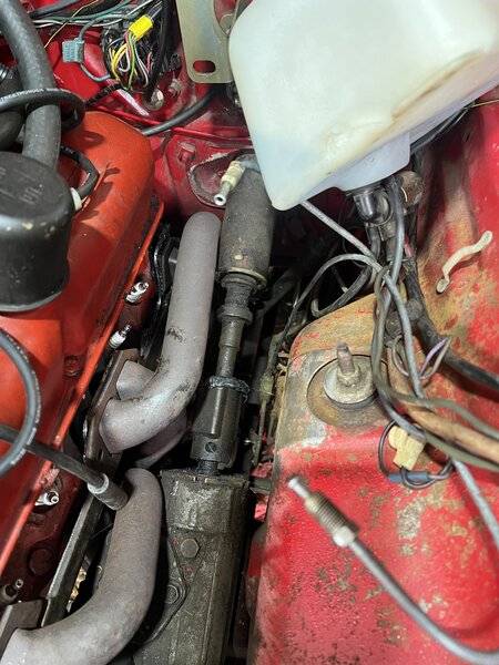

Or go this route like I did on my 65 Dart unlessView attachment 1716423144 your dead set on the Mopar one

I’m not sure how different the 67 is to the 65 but my steering column came out pretty easy. I also did order that quick fix rubber boot for the coupler. I would go for that u joint style but I’m sure it’s more money than I’d want to spend. Perhaps in the future I’ll go for it!

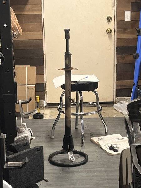

In my picture post #17 did it for about $30 or so that was for a new bearing in bottom of column, u-joint and a couple steel bushings for added length for going from power to manual

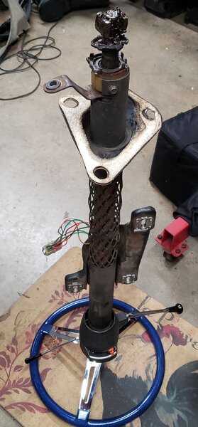

65 or 67, pulling the steering column is at most a 15-20 minute job. See #5 (my 67 Barracuda's column). On my 67, three bolts on the firewall plate, 3 bolts on the column support under the dash, one electrical connection, one roll pin and - if you have a column shift automatic - one clip for the shift rod. Then the column just slides out.

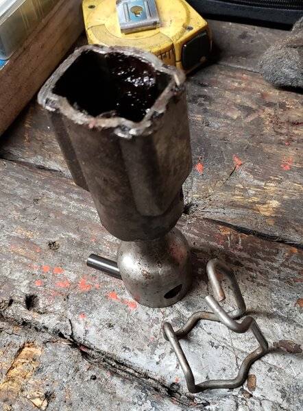

For what it's worth, I finally got around to putting the clamp (post #5) on my 67 Barracuda's coupler. With an assortment of screw drivers, pliers, vice grips, a hammer and no small amount of cussing. What a PITA. I'd say the cover sold by Bergman Auto that RRR recommends (post #11) would be a lot easier even for the couplers that have the roll pin which, as covered above, the OP's 65 doesn't have. Anyway, here's my 67's coupler:
My 67 was the same bs. I gave up and used hose clamp lol.
