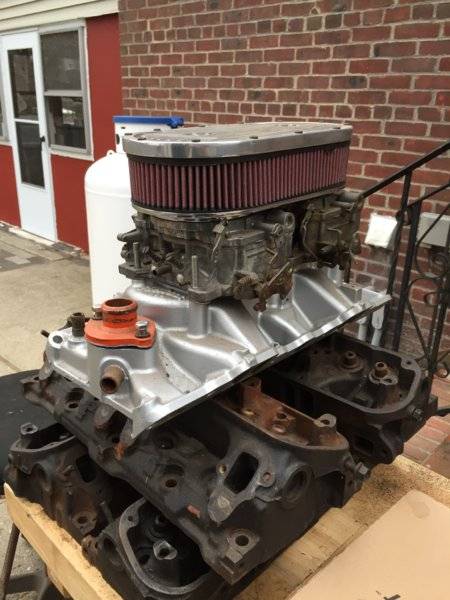

Stock 360 4bbl intake

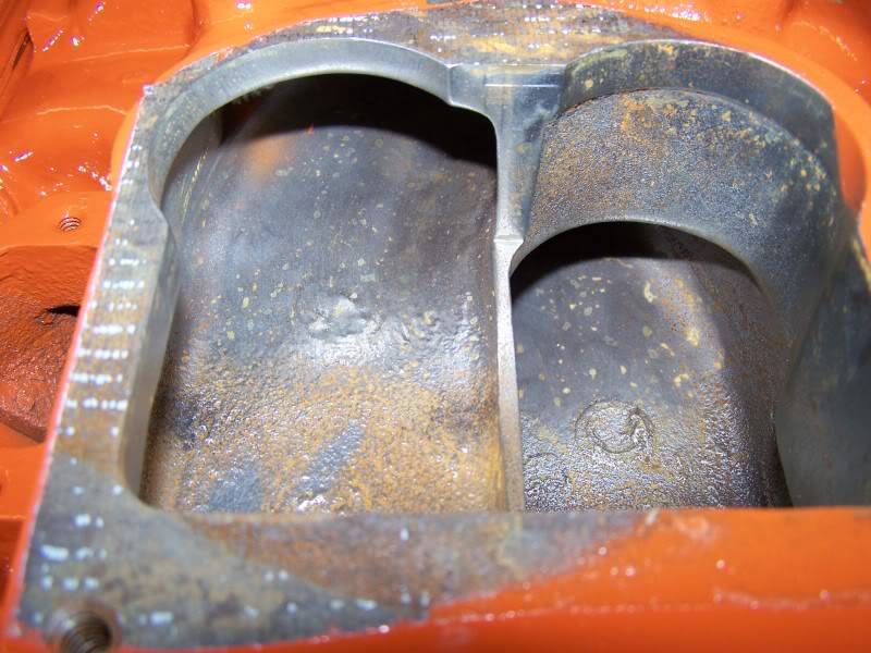

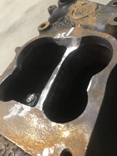

I have seen that manifold support a 444ci stock appearing duster to 11.40’s and a 422 ci duster to 11.75’s. The divider question is tough to answer. I believe the current thinking for using that manifold for race only is to cut the divider down. This is my 340 intake and is cut a bit lower than ideal. I made a test divider that I could remove. My “race” only combo liked no divider. I didn’t lose any 60’, but it got a hair easier to launch the car.

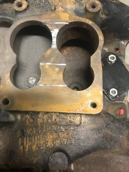

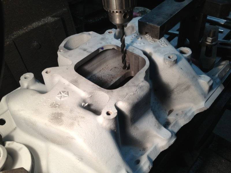

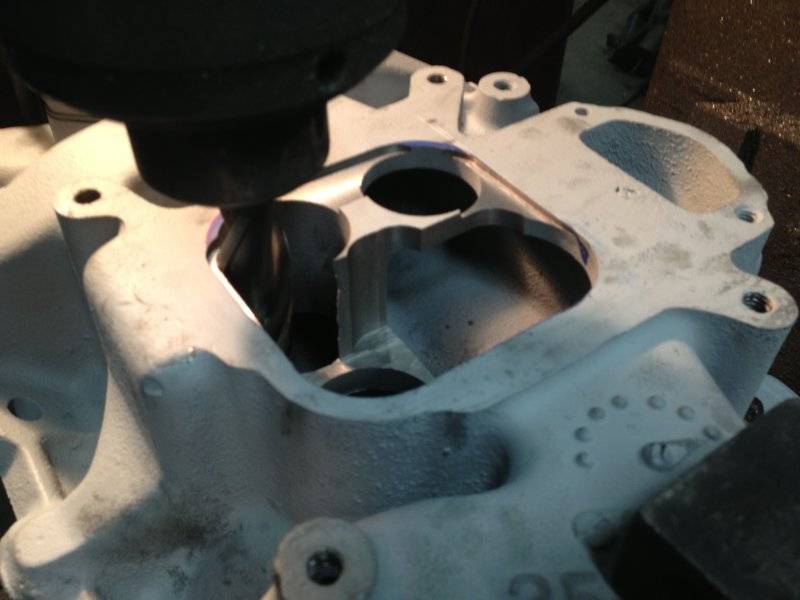

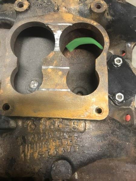

Being is how this is really me just practicing on this intake, it’s not all the professional or pretty. I still have some cleaning up to do but ran out of time this weekend. There was a lot more metal to remove than what it appears lol
Good start! I would make sure you rounded the edges so the charge can start the turn as smooth as possible. The side wings are wasted plenum volume.
Yep that’s my plan. I think I’ll cut the divider down just a hair more and then smooth out the inside of the intake and throat as much as I can

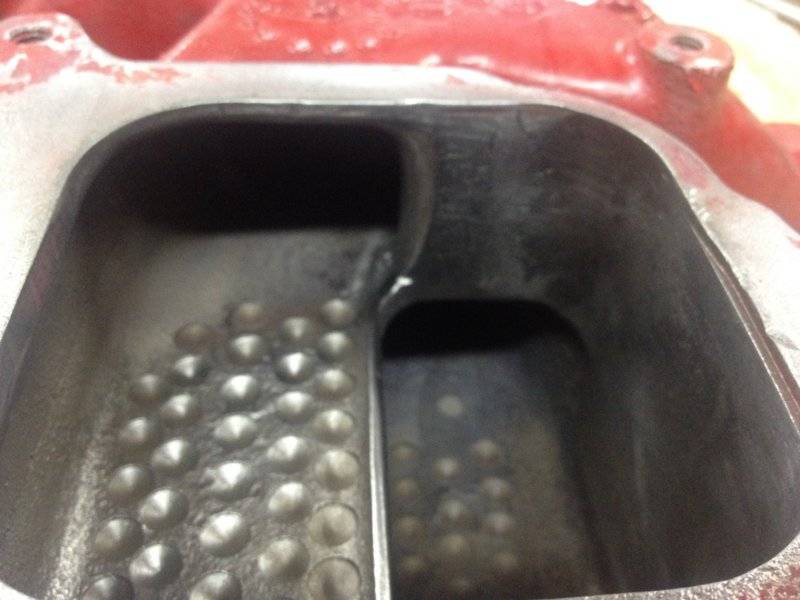

me personally, I wouldn't go "down" any more. You can always add a 1/4 inch spacer under the carb IF it needs it.

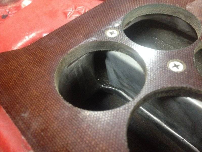

and here on both ends. These intakes respond well to carb spacers because it gives the charge more time/space to start the turn instead of just slamming into the plenum floor and puddling raw fuel. Which then runs down the runner floor reeking havoc with the a/f ratio.
