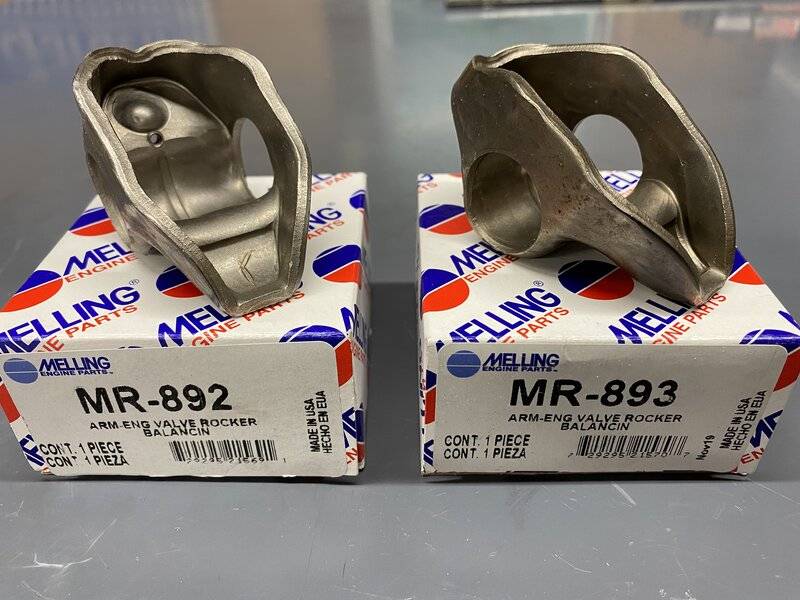

I forget who exactly sells new Hyd rockers, but I did see them not so long ago. Perhaps Federal Mougal? Dang! I can’t remember.
I got a set of Melling rockers from Rock Auto a little over a year ago, boxes show Made in USA.
