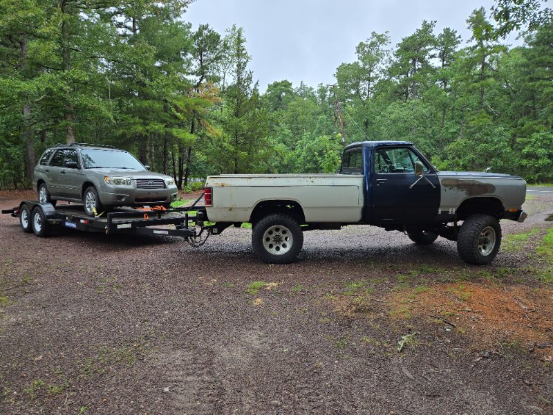

I'm stranded at the Wawa with truck, trailer, and a car for my daughter I just picked up.
No spark, found a coil, I think it's the magnetic pickup, found one nearby, arrives at the parts store at 3:30.
318 in an 84 Dodge.
My fear is it won't be a match for this distributor.
Thoughts?

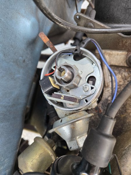

2-wire pickup + vacuum advance = not Lean Burn.
Gonna be difficult to set the pickup air gap in the field without a nonmagnetic 0.006" feeler gauge, but two sheets of regular printer paper will do in a pinch.
If you have a Mopar ignition box (original or replacement) be sure the body of it is chassis grounded really well. That can cause a no spark condition.

So I couldn't get the reluctor off to replace the magnetic pickup. My understanding is it should be held on by 2 roll pins, but mine had some kind of wire snap ring.
Guys at Napa found me a new distributor, at another store, so went and got that (the guy I bought the Subaru from brought me).
Stabbed it in, no spark.
These 2 guys asked if I needed help, we bench tested the old coil, it's bad, and bench tested the new coil, it's good.

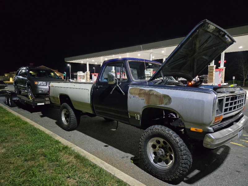

Very long story short, when I crank it now, no spark, when I let of crank coil wire sparks, and when I turn key off coil wire sparks.
Me thinks that means the ignition module is bad, which is the only thing left to replace, which I recently replaced already, so I had ruled it out early on.
The score now is the coil was bad, the module appears to be bad as well, and I'm sleeping in the Wawa parking lot.
When you turn off the key the circuit collapses causing the single spark... The module/pick up coil normally does that constantly... Chryslers Electronic Ignition was problematic to diagnose/repair in the 70's/80's... Now the parts quality only makes things worse... Much worse...
