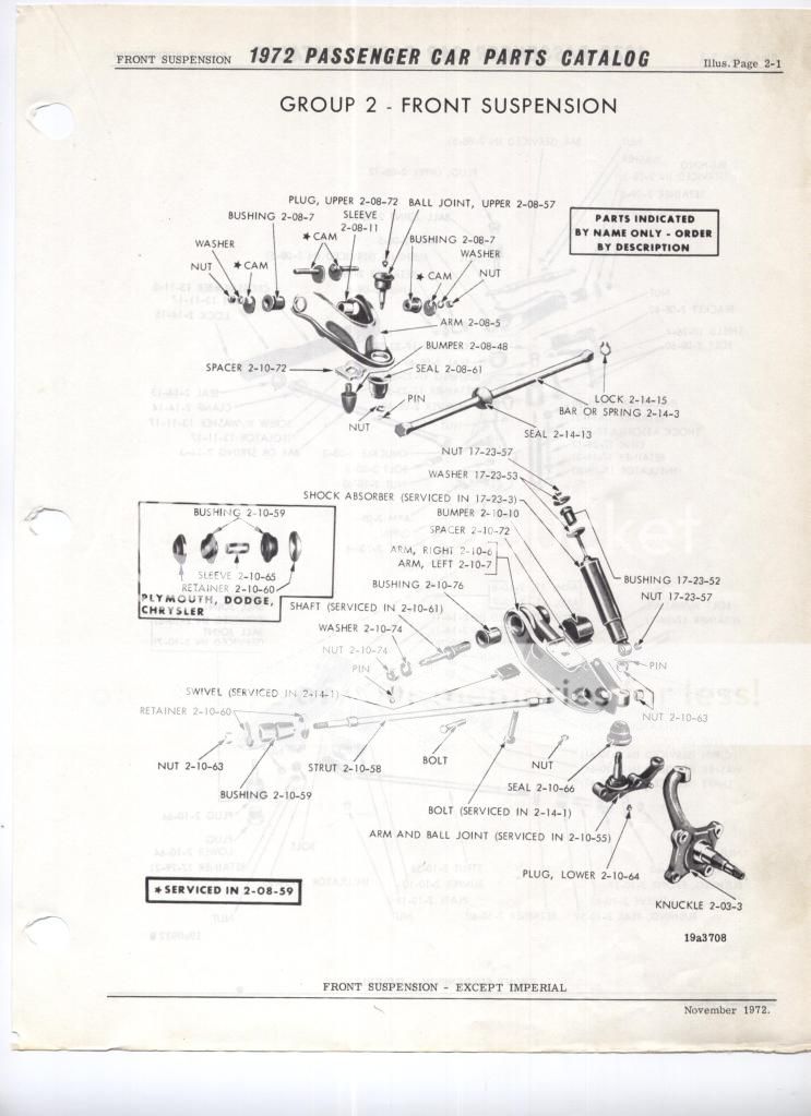

Hi Guys,
Mopar used two styles of strut rod bushings either style will work just fine with your car. We back all of our products with our life time warranty. I have the style that you have on my 72 Duster with no issues. Attached is a scan from a factory mopar parts book I hope this helps.
Thanks
James From
PST Marketing Supervisor

Thanks for the help on this James. That page will also come in handy! Also, I did go ahead and get the Moog part, K7040. I talked to Mancini and they said that part number would work with their strut rods. I'm not trying to knock anything that PST does (I'm using their kit on everything else in the front suspension), I just wanted to get these upgraded bushings since it seems to be one of the more common parts I've read about people having problems with. Thanks to everybody for the help and input! :cheers:
