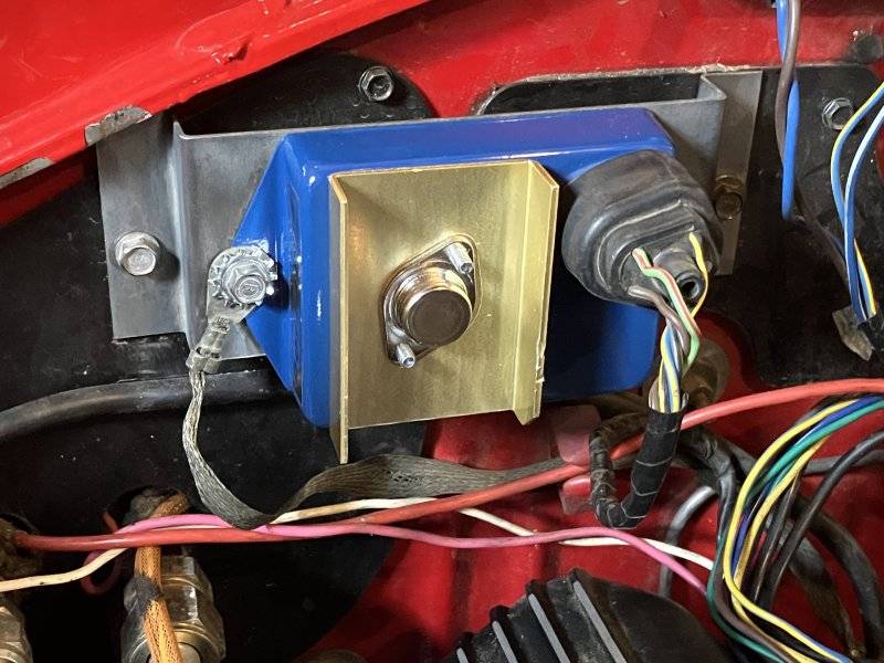

Am I the only one that's considered making a bracket with a drip tray under it to catch crap before it bukkake's my firewall again?
Edited to add holes for ECU lol
Edit that lip 180 deg. you guys seem to not understand how these things mount.
I just slapped it out, that's not to scale and it is not currently laid out to re-use the original holes (which I would pretty much insist on...
but as for orientation, I gotta disagree.
I'd like to see a bracket that has the entire part under the potted material open to air. Then, I'd be tempted to buy.
I always thought of making a bracket to mount the ECU with the back side up. I know it would look like hell but at least the goo wouldn't go any where. I've never done it, anyone see any downside of doing it?
The bracket I linked does just that Rusty, how are you guys not seeing this?
I`ll explain, The solid part gets mounted to the firewall or inner fender, the two upper flanges is where the ecu mounts. Do we now see?
Maybe I missed it. Lemmie scroll back and look.
Ok. I did miss it. So the offset holes let the ECU hang off the edge and expost the back side. Yeah. That'd work.

I can do that to the one I posted earlier if you want. I'd prefer to make it re-use the original holes, but it would be easy to make a flat that has a hole in the center with a couple spacers for the airflow.
But as shown, I think the potting's gonna spooge whether it's hot or not.
I'm sure you're right. It just "seems" if the potting was somehow exposed to airflow it might last longer. Probably one of those things that doesn't work anyway. lol
