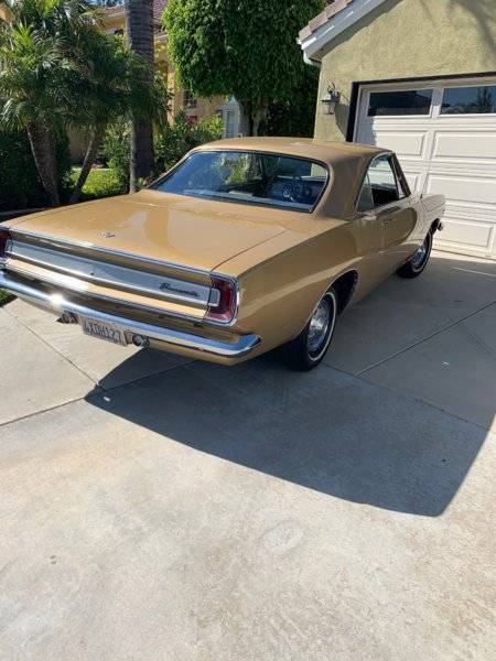

So, do you by any chance know if this same tone ring setup could be used to allow the use of the factory Challenger gauge cluster? since I believe it gets the speed input from the ABS module.With the NAG1 Transmission a signal must be sent to the ABS module. Need to install a tone ring and wheel sensors to the transmission yoke.
