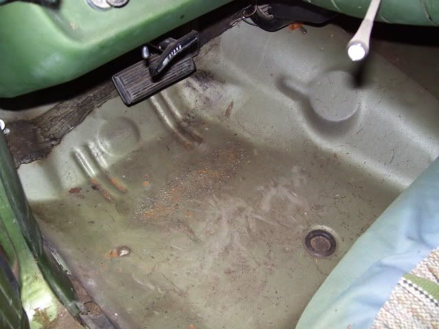

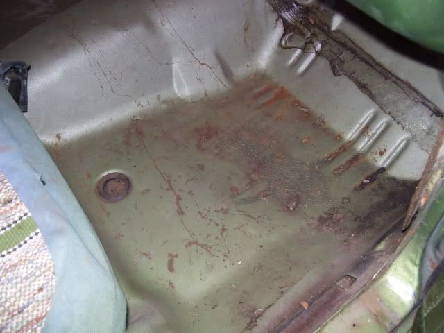

Look at how solid these front floors are.
Floor pan looks pretty clean. I'm about to gut my interior to get it ready to have the subframe connectors welded in. Hopefully mine will look as good as yours does.
