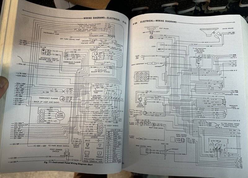

Got the big color chart for wiring the car. I’m going to attach it to a smooth piece of plywood and then tape over it with clear packaging tape to keep it nice for a long time.
An time I guy a project, there are a few things on must have list, 1. FSM 2. that laminated color keyed wiring diagram!

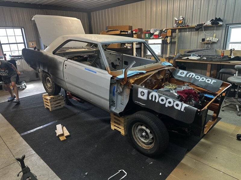

Painter came over yesterday. He asked me what I wanted, body work wise? Idk I told him I want it to be really nice, smooth body and clean paint. I want like really nice….
I’m going to add mini tubs, that way it’s done and I don’t have to worry about cutting and painting again later on if I want them later.

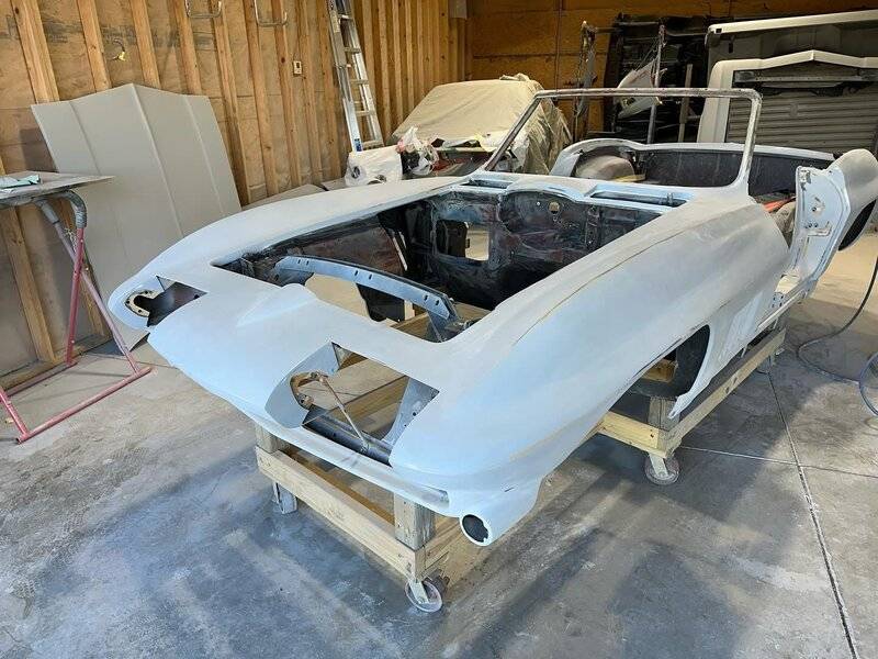

He is going to get back to me with a date/time he thinks he will be able to get it in shortly. He is currently finishing a 67 corvette convertible paint job, it is using paint that costs 2k per gallon!
Part of me loves the copper but other parts of me think I should go back to a blue. How did people ever decide on a color to get their cars? Every time I say I want a new truck I always pick black or blue…
Here’s the corvette, it’s a red color now but I don’t have pictures of it painted, he just showed me on his phone.

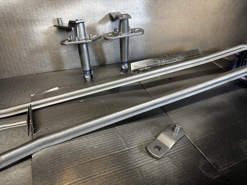

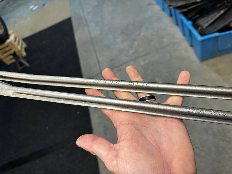

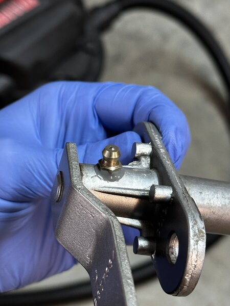

Wiper pivots and wiper pivot arms got cleaned then painted with some “Stainless Steel” colored spray paint from tractor supply, it looks great! Also dries super quick which is good.

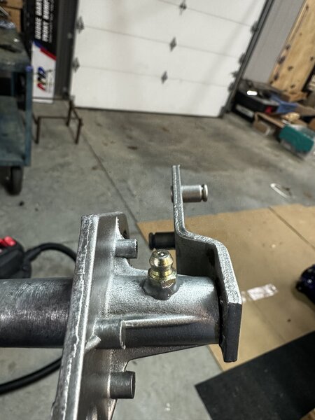

Wiper pivots I added zerc fittings so I could regrease them. I made the one hole a little bigger unfortunately… so I sealed it all with a little JB weld. We will see if it works after the JB dries, if it functions nicely I’ll finish painting it. If not I’ll add a new pivot.
I have new gaskets and everything for them but don’t need to install them all yet.
Paint on left is the one I’ve been using.
Well the wiper pivot I kind of blew the hole out on, that wiper pivot spins perfectly . The one that I drilled “without problems” has a hitch in it when I spin it. I need to finish filling it with new grease then I’ll try it some more, if it still has a hang up I’ll have to grab another wiper pivot. I may have one or 2 laying around somewhere.
Two thousand dollars a GALLON?? I know Ive been out of the trade for a bit, but that seems pretty outrageous for paint. Can you find out what it is? Id really be interested in knowing what paint costs that much money. Unless he was talking total materials, thats more understandable.
some of that translucent paint is crazy $$$ but a gallon can spray a couple of cars think it just added to the clear
I know that chameleon (or color change) paint was crazy stupid expensive when it first came out, but that was decades ago, it must have calmed down by now.
Who knows
The clear coat that gm came out with to cover cabonfiber on the newer zl1 was something like 1000 a pint
