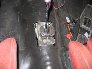

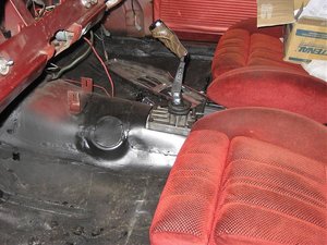

Some pics of shifter locaton and hyd clutch master on t-5 swap.
I took a rough measurement from the seam sealer at the foward part of the tunnel back to the center of shifter handle;roughly 18.5".The stick I'm using is 8" with a 4"sweep puting the shifter ball approx 22.5-23.0" back from that seam.

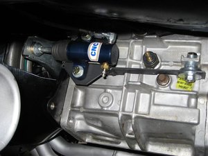

I am currently finishing up my T5 conversion in my 67 Dart w/360. Used a T5 from a 92 mustang gt that I rebuilt myself, quick time bellhousing,360 flywheel double drilled for a ford 10.5 clutch. Input bearing from Keisler Engineering. Used a clutch fork for a 92 mustang.Long pivot ball and adjustable throwout bearing from Mcleod. Stock A body 4 speed pedals,wilwood master cylinder with firewall adapter from keisler. CNC push slave cylinder and rod. Had to cut, modify, and weld the torsion bar support across the trans tunnel as the shifter comes out on the back edge of the support. Had my driveshaft shortened 1.5" and a T5 yoke installed. I haven't rounded up all my pics as of yet but i do hope to have it back on the road soon to road test it.

the adjustable throwout bearing is made by Mcleod pt# 16515. the biggest problem I had when starting this project was finding info on which components to use, Mopar or Ford. The hydraulic T.O. bearing is by far the best way to go but is also the most expensive. Mcleod pt# 1319. If you use Ford parts w/o the hyd T.O. bearing you have to use a push slave cylinder to operate the clutch fork. If you use the mopar clutch fork a pull type slave cylinder must be used. I couldn't figure anyway to use a cable type of setup because of the shape of the bellhousing.
i had a hyd bearing for 10 years in my car ,,it was a nascar style,,it never really had the correct amount of reach ,,or travel,,it finally went bad,,so i converted back to a stock fork/t bearing and made a set up with a puller type slave,,seems to work great,,,i had tossed around the idea of adapting a mustang style clutch pedal and cable,,also i like that you used the ford fork and throw out,,that cures other problems with this swap,, i will look in to this adjustable t bearing thanks for the part numbers,,

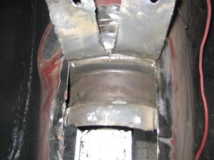

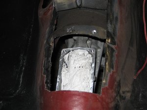

Just so everyone knows going into this, you will have to cut & modify the torsion bar support that runs from side to side under the floor. I will post a few of the pics that I have. There are many ways to do this i am sure but this is how I did it. Important note. before cutting the support I would recommend letting all the tension off of the torsion bars. I am going to add subframe connectors to my car to help add some more support to the torsion bar support.
Torsion bar support mods
The whole center of the support has to be cut out except the top edge just underneath the metal that is bent back. If not the trans will not sit high enough to get the correct driveline angle. I did not cut the entire support in half. I'm sorry. I can't find the other pics. I then cut a piece of 1/4" steel and made a bridge that went from one side to the other and is the same height as the top edge piece and welded it on both sides and along the back top edge. I then cut a piece of 3/16" steel and laid it across the top of the whole opening hammered and tack welded it in place for extra support.

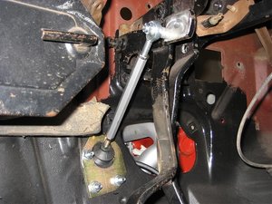

anyone have more info on the clutch pedal? i like the looks of the last set up by 727jetdr. but cant figure out how it works lol. 737jetdr what slave cyl, etc did you use? and where can i find the same stuff to look at it?
