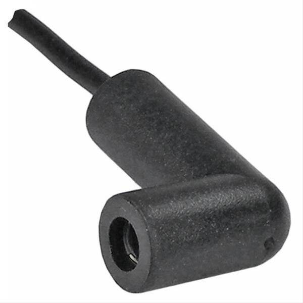

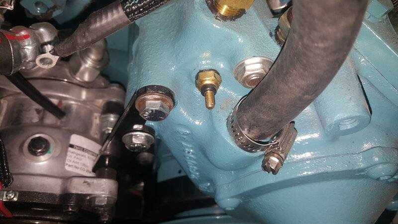

I have my temp gauge sender here on the water pump housing. I am having trouble figuring out how the wire attaches. I crimped an end on the wire, but not sure what thread that is. I tried #10-24 and 10-32 with not luck. No damaged threads. Is this one of those slide on connections? the little rubber/plastic piece at the base of the threads leads me that it might be. If a nut came with the sender, I lost it long ago. Small little stupid thing.:BangHead:
Thanks Ladies and Germs....
OldManMopar (as usual!!) is correct, but "I think" it should be 8-32 if you don't have/ can't get the push on deal. I think Ford used the same basic terminal on the starter relay
I just did what OMM said to do. part is on the way. Very close to trying to start this thing.

Looks like that sender is tightened all the way down to where the head is against the water pump housing. Yikes, I've never had to tighten one up that far before.
