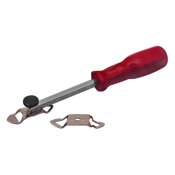

Front glass installed today, that front lock strip ain't no joke! Of course to get the glass in I had to have fun with the wiper linkages and reinstall the dash.
The lock strip takes a special little tool. Is that what you used? Makes it very easy to do.

and only one bone tool for both the front and rear. As you may Know the rear on any 60's era Barracuda is a tough cookie! The 67 to 69 the easier!

Only tool Southern used on my fish front and rear. To both seat the glass and set the lock strip. He left it with me.
