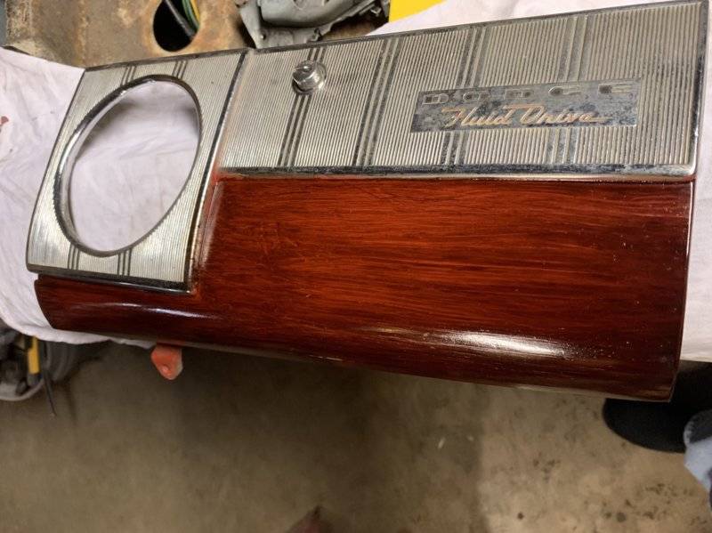

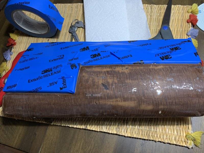

All the window metal moldings and dash were originally woodgrained which I plan to keep. The few companies that do very nice woodgraining are beyond my meager means, so I think I can do it myself. After watching a few You Tube videos I will give it a try. So the glove box is wetsanded and masked in preparation for the base coat.
All the window metal moldings and dash were originally woodgrained which I plan to keep. The few companies that do very nice woodgraining are beyond my meager means, so I will be doing it myself. After watching a few You Tube videos I will give it a try myself. So the glove box is wetsanded and masked in preparation for the base coat.

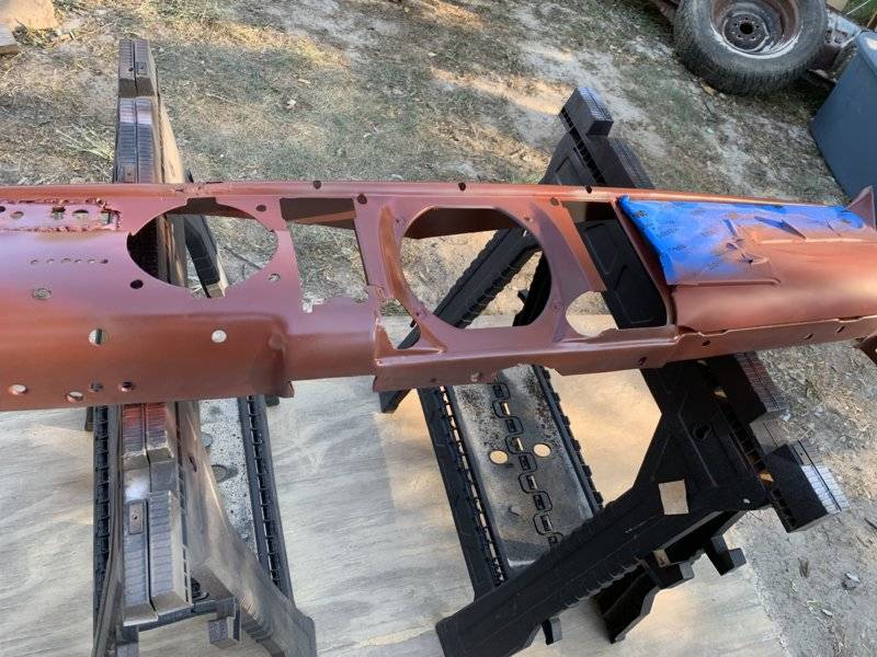

Well, time for a little update on this project! Sandblasted the blue paint a PO did on the dash and the OEM base coat and woodgrain that that was present. Got the first application of the base coat on. Now it’s time to wet sand and apply the final coat of the base coat before trying my hand at woodgraining - thanks to You Tube for several videos on this!

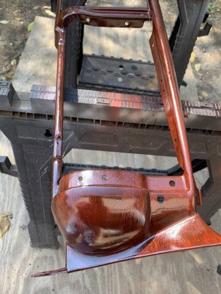

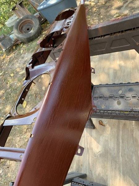

Well got the First coat of MinWax stain applied over the base coat . The procedure is apply the stain with a reasonably large brush - I used a 2 inch brush. While still sort of wet, take a smaller brush - I used a 1/2 inch brush - called a dry brush and start laying out the grain. Keep the brush dry and use long even strokes in the wet stain. I am not looking for an OEM woodgraining effect - just a nice woodgraining effect, which I like how it’s turned out so far! Next step is a light wetsanding and do the final coat of wet and dry. Once dry spray clear with a hardener over everything. Looking forward to assembling all the shiny pot metal with the gauges and switches. After it’s all completed, I’ll bag the dash and store it in the rafters until time to install it - whenever that will be!

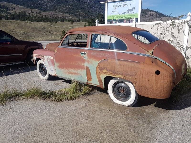

So i grabbed an old project too, 1949 fargo. Want to keep the original flathead,if i get it unseized.
I fell in love with the styling when i saw it less than a week ago.
