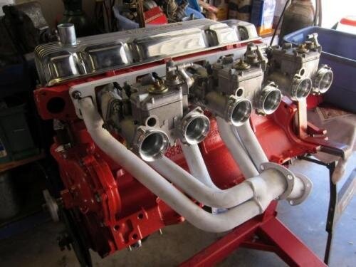

This was a mock-up i was trying several years ago. I love the looks and potential with the Webers; the headers aren’t too bad either
I will use the 42RH auto with OD behind the slant with the adapter plate I have
Hi Don.. Do you have a pic of the adapter plate? That would be interesting. Looks great. Sgrip65.

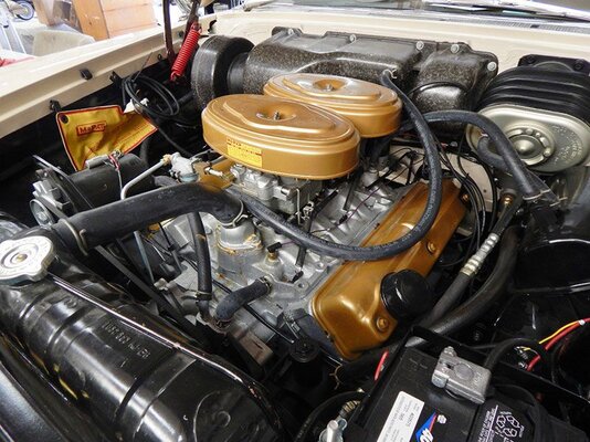

Well, the edit in my post #278 shows that I’ve sold the triple Weber setup so no exotic slant motor. In the slant’s place I’ve acquired a 79 truck 318 which is perfect for the 47’s chassis since it’s a rear sump as it sits. To give this motor some eye candy and a little omph I will be picking up a complete D66 setup including matching carbs, linkage, choke and oval air cleaners from another member. It is basically similar to this setup on a 58 318 poly. I’ve decided I will copy this look with the silver engine and gold valve covers.
Don! That will be great look in your engine compartment.

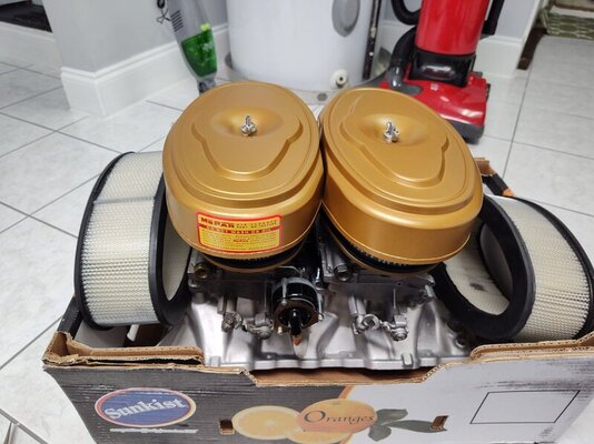

Picked up a 79 truck 318 the other week as well as picking up my D66 with rebuilt carbs, linkage and everything else to make it work and a spare set of air filters
No pics but on the motor there was a 4 barrel intake and a set of chrome calve covers. Once I get started on the motor, I’ll probably list that stuff for sale
Those air cleaners looks so good.

This is pertaining to post 284 with the engine with the dual 4’s and gold air cleaners - here:
This engIne also has matching gold valve covers. I have a set of standard covers that I could use but decided I’d rather have a set of finned valve covers that could be done in matching air cleaner color like these vintage Cal Customs
I found a set (picture from another set for sale) and bought them from another membe. He shipped them to the Mistress of Metal to match them in the same color as one of the air cleaners i shipped to her. I think they’ll look great!
