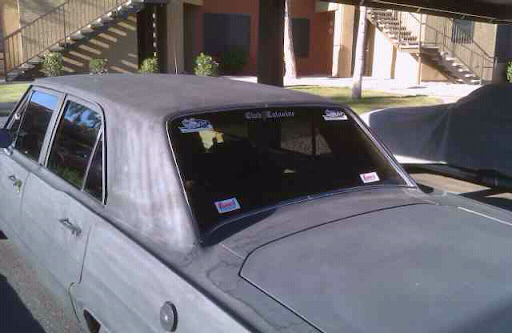

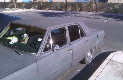

Other than that - My buddy Joe at the Chandler Audio Express store tinted my windows. I will post the pics here in a bit. Other than that - no work has been done. I am stuck on where to start on the interior, but I guess I had better start by starting. Hopefully, more to post this weekend, as I have a date with Joe's driveway and the Brick!
Not bad for the price I paid - free. Joe was learning to tint so the Brick got done for free since I did not specify the darkness of the tint. If you are in AZ and want your glass tinted, swing by the Chandler Audio Express Tuesday through Friday, and ask for your windows to be tinted by Joe W. and that Mike J sent you :)

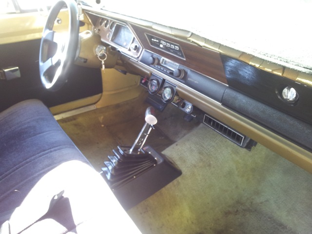

As a quick update - just had a recent trans rebuild at a local trans shop. 904 is done, sealed up tight - installed a B&M Shift Improver kit, so the trans is nice and crispy shifting now, and also installed a B&M Star Shifter, and removed the column shift lever.
So much nicer to drive now.
Also, finally took a stab at redoing the interior door panel, since I had to fix the window on the drivers side front door. It was as simple as peeling off the old cracked vinyl, cleaning up the boards, rolling out the O'Reilly automotive grade carpeting, cutting a piece to fit, and then gluing it down with 3m Auto adhesive.
I left the armrests off until I can figure the best way to refurbish them.
I had to run off to Subway to grab some sammiches, so I figured I would grab a picture of the updated front interior, or at least as it is now.
I promise, the last post on my own thread for the night - got to get some homework done, and start plotting next Sundays madness (thinking finally doing the dash refurb, and setting up the rear deck liner.) Broke as a joke now, so will be doing stuff with what I have on hand.
