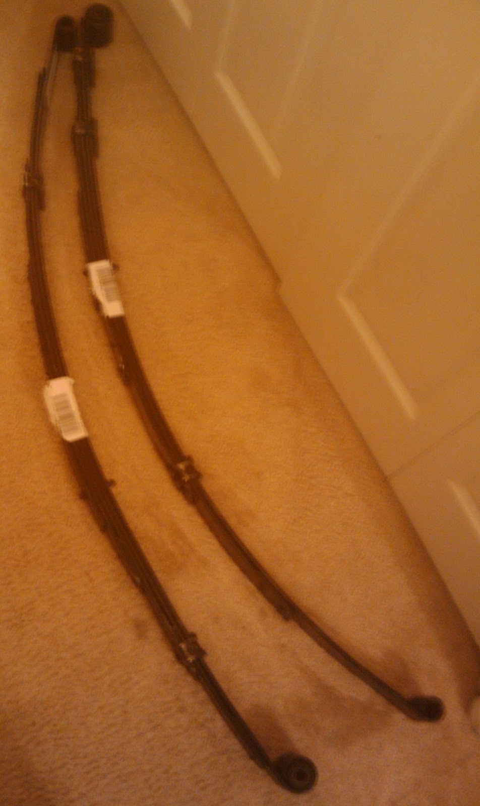

Springs came in last week, as well as a few needed parts to get the rear all setup to go in.

Got the Springs put in. They went in pretty easy. Bolted the front spring hangers to the springs first and then reattached the hangers.

With the advise pulled up from my suspension thread, I re-tackled the leaf springs. Pulled them back out, switched sides and put back in about an hour and a half. Man what a difference. I guess my eye ball front end alignment worked put pretty well, cause the car ended up pretty level.
