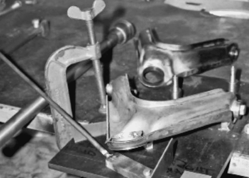

How about this?
How about cutting the UCA on the forward leg, spread it 1/4" and welding in another section?
Properly welded, it wouldn't fail. The slight change in angle will affect the rear bushing slightly but not enough to matter. This can be done for next to nothing. The 1/4" piece sectioned in could come from small ball joint UCAs that are not as valuable to some people. By welding in an extension, you'd still be able to use any type of bushing, offset or stock so there would still be the same range of adjustment.
Opinions?
Here's the article with the picture on the modified TransAm car UCA's. They were modified at the ball joint mount, which was tipped at an angle as well as replaced with a larger ball joint (larger than the standard B/E stuff).
Building the AAR ‘Cuda Trans-Am
The modification was done for the larger ball joint and to change the angle because of the amount the cars were lowered, not sure if it also increased caster but there's no reason it couldn't. I don't think they cut the arm of the UCA at all.
Doing the modification at the ball joint would be stronger, the area in the arm will have more flex than at the area around the ball joint. Plus the bushing ends remain aligned, so you run less risk of adding some binding into the travel.
The other thing is that lengthening the arm will also push the ball joint out some, so, you'd lose camber and potentially widen the track a little.
I think the spindles are symmetric, and it's really unlikely the mounting holes for the steering arms are off a 1/4" on a machined part since the tolerances for that stuff is in thousandths.
