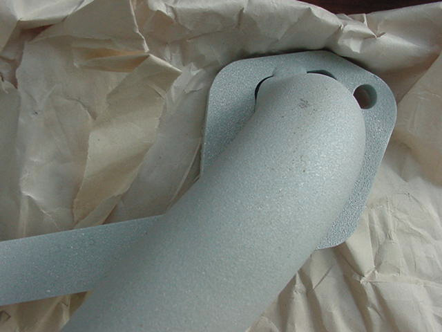

There are different types and grades. Years ago (when I had my speed shop) I used a spray-on coating. I found out that even with meticulous prep work, it would still flake off over time. There is a flame-sprayed version, where the ceramic dust is blown onto the part by a torch flame. I've been told that's the only process (at that time) that holds up well.
On a side note, there are also header wraps that do a better job of heat retention than coatings. I wrapped the stock exhaust header on my '95 ZJ 4.6 stroker.

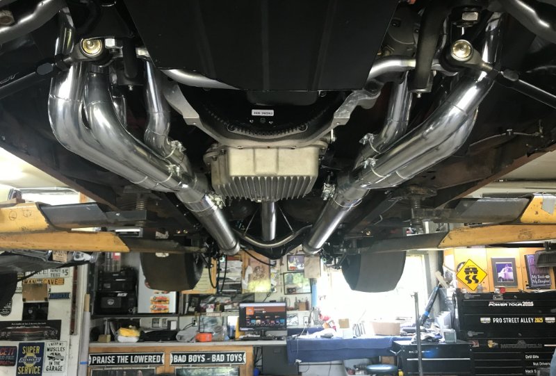

QC Coatings in Shelby Mi. has the best I've seen. They coat inside and out....and warranty their coatings. Great car guys, and great business. Give Bill a call...
They've done all my ceramic and powder coating, for decades. If it isn't right, it doesn't leave.
Home | QCCOATINGS.com
My latest set of headers and exhaust on Krusty...

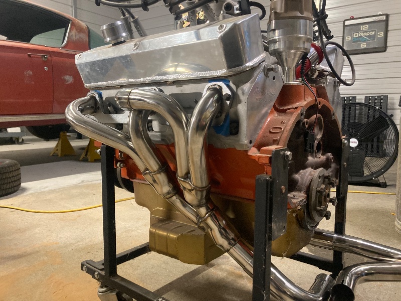

`cuda headers

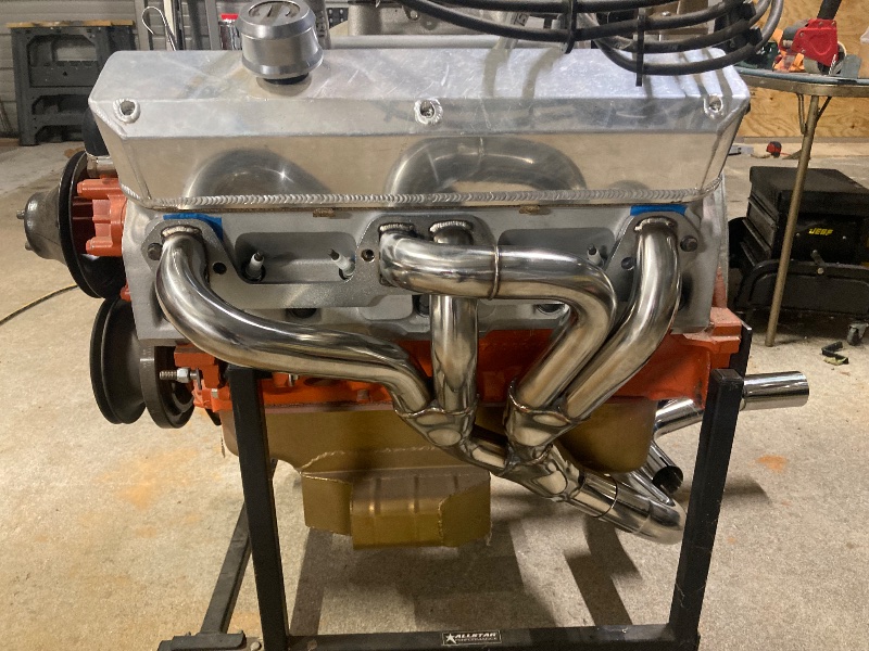

Aspen pro-stock headers

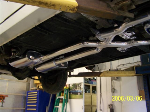

2nd exhaust on wagon
