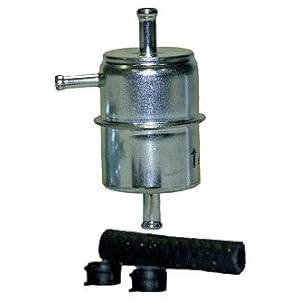

or if you don't use a regulator, use a fuel filter with built in orifice
Wix 33040/ 41 are 5/16 and 3/8 filters,
33054 is 5/16 with a 90* orifice
