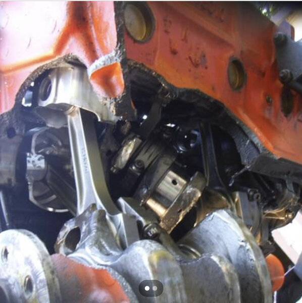

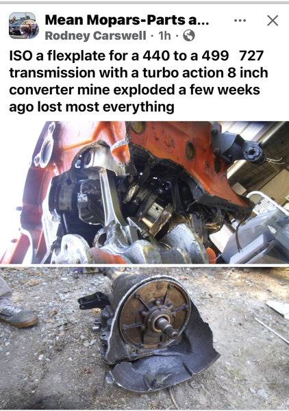

This gets expensive real quick. Not mine.
pittsburghracer
Legandary Member
Legendary Member
Apr 20, 2016
17,715
41,195
Freeport, PA.
Ouch.
Knock on wood I’ve been blessed over my years to never having done that to a big or small block. I would say 8.60’s@155mph with a stock 440 block and 9.38@138 with a stock 360 block is pushing them pretty hard. Probably a little quicker than that with my current 360.
I like engines with “sight glasses” built in. You really know what’s going on.
Seriously I hope the driver was not hurt. Lessons learned but once you loose a foot, blankets make way more sense.
Anytime I build something that is intended to run in
the 8's, I use an aftermarket block. Never had a converter
explode, and I have killed my share, but at that point it really
wouldn't matter what block it was behind.
I’ve taken stock forged 440 cranks out in two pieces, one piece with lots of small cracks (every three years) 440 block with a crack up through the mains that I found during rebuild after 275 (8.60 passes) and a few connecting rod mishaps but nothing that looked like that. I’ve been blessed.
