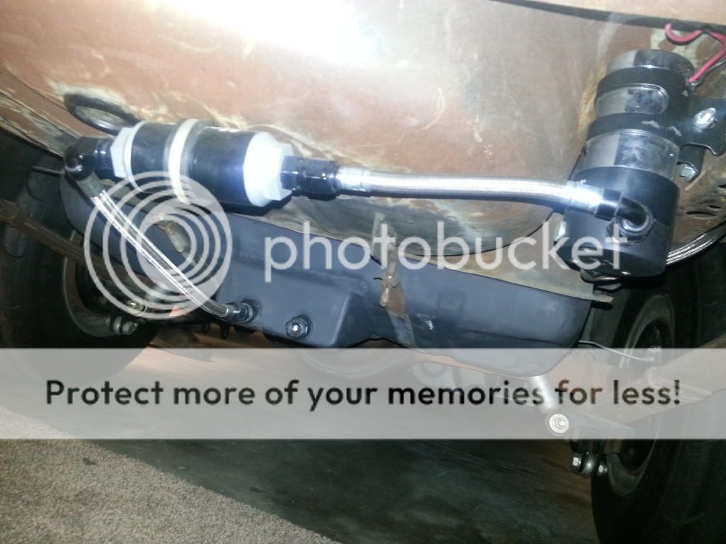

The OP didn't ask for this, but while I'm thinking about it, I am using the GM EFI fuel filter. Might need two of them in parallel for a high demand drag car, but for anything else one should be more than enough. They're rated at 10 microns (4 to 10 times smaller than a typical carb filter) and are at least equal at the inlet and outlet to the ID of a -6 fitting. Pressure drop looks to not be a problem. They're cheap and everywhere, so replacements are easy. They're fairly large, so you aren't going to plug one up very fast. And there are -6AN adapter fittings made so you don't have to use hose clamps if you don't want to. The can is stainless, so I guess a guy could polish one so it'd be all pretty and stuff. there are some pics of all of this in the link in my sig.
