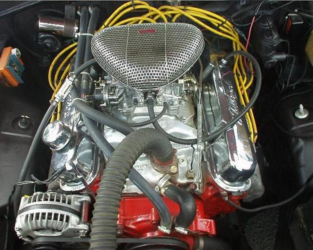

if I remember correctly, the filter element is foam, and not always fire retardant...specially once it soaks up some gasoline fumes
I would steer away from that one unless you want to end up like this
I was going to say I have seen quite a few of those that have burned up, but you know what they say about a picture. :D
I've only heard the same things. Fire and chunks. If it doesn't start on fire. The foam breaks down and gets sucked into the engine. I would avoid one.

Been there. Once the fire ensues and melts the plastic frame that supports the foam, you then get to pull the carb and clean the plastic off the butterflies because they don't close. Mine ended up in the circular file about 1990.
No doubt it's similar to the "flies eyeball" I have on my shovel head. That thing runs like a tractor though, no amount of air flow is gong to help it.
You can see through the foam out of the box. No way that is going to filter anything short of bird feathers. you see them at swap meets and the foam is either burned or gone.

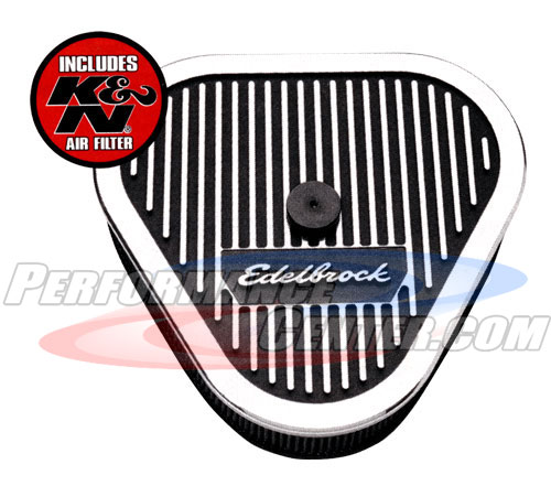

Well, it was inexpensive. I like the ribbed Edelbrock myself. Not the price though.

If you are hell bend on running one, I would suggest you buy a sheet of spark arrestor mesh and incorporate that into the filter, between the carb and the foam
Decades back, I had one of these on the 340. All you need is one backfire and the foam melts and drips into the carb. The resulting melted foam turns into a sticky glue type of compound. Do NOT run these. Get yourself a round, triangular or other shape that has a paper or K&N style filter.
