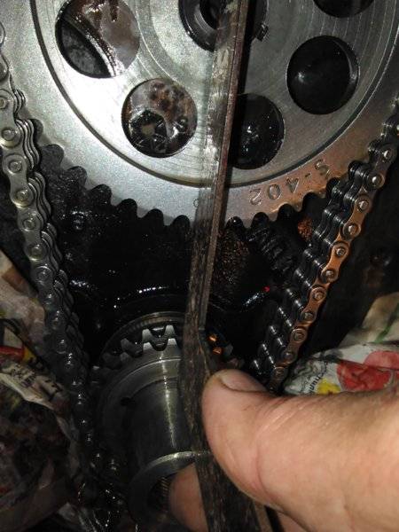

In your opinion, Del, from these crappy pictures, am I a tooth off?

Straight edge, center of the crank to the center of the cam bolt. Mine is 180 out but you should get the idea.
Take the fuel pump concentric off for a more accurate look. Straight line point A(crank) to point B(cam)
