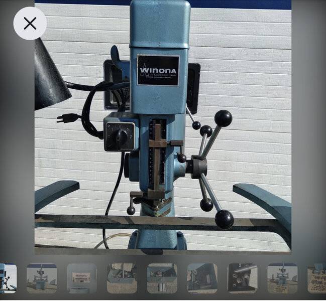

Honestly I rarely have my big block head adapter on my bench anymore. And when I did earlier this year to flow my buddy’s Victor head I had my big bore head adapter on. I guess curiosity has never beaten out laziness. Lol. I finally got my Winona valve seat grinder wired up and leveled up this week. A buddy of mine that had used one is hopefully stopping over Tuesday to shorten my learning curve and seeing what I should order from Silver Seal or Goodson. Intakes are supposed to be dropped off by my son today so I’ll get started on those ASAP.
Cool, a floating head bench?
Yes Sir. I think I’m going to like that. I ordered and got a laser rpm tool yesterday so I can calibrate everything
Very cool. That's what I learned on last June & love using it, nothing else to compare to but I like it.
Favorite thing was getting use to running reamers thru guides when the table is floating it is easy now but I thought something was going to happen bad at 1st. We use goodson stones, I'm not sure who makes stuff like the seat cutters and other bowl hog cutters we use, enjoy !

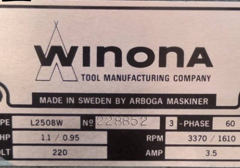

Seat grinder that needs leveling?
Or is it a guide and seat machine?
Model number?
