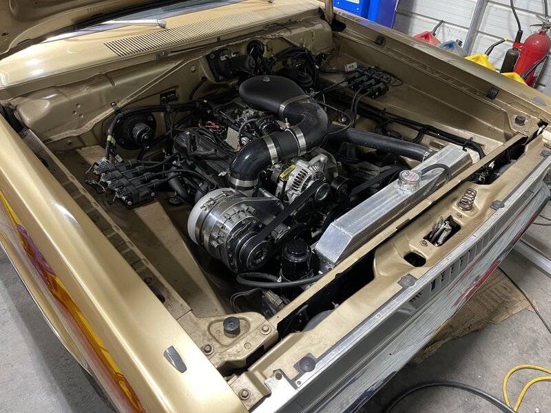

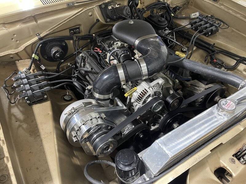

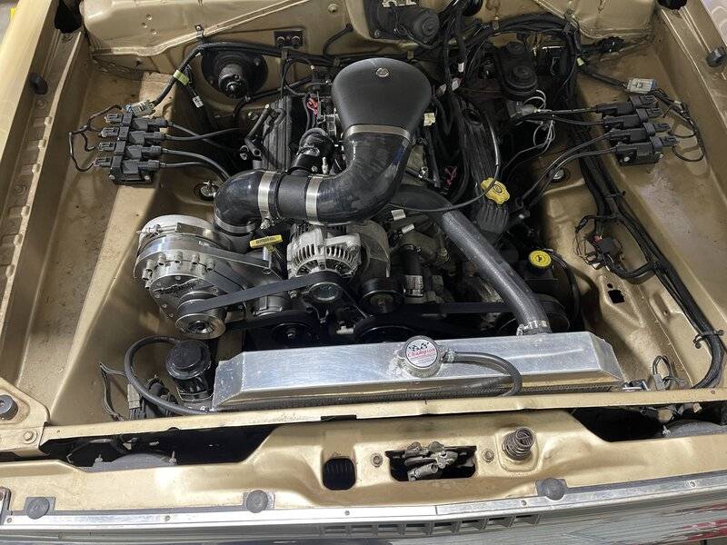

Just finished up the torqstorm install on the 360 magnum in my 1971 Scamp. Need to dial the tune in quite a bit but it’s good enough to idle for now. Uploaded a short idling clip to my YouTube.
That looks great! Super clean install. I'm looking forward to seeing how she runs after tuning. Which ECM are you using? Will you spray any Methanol?
I'm curious as to the source for the air hat and ovalized transition from the round boost tube to that hat on the throttle body? I need one for my build.
Using holley terminator X for engine management. First thought was to use an air to air intercooler. However, I have no room for that. I need to plumb an IAT sensor to the tophat to see what my intake air temp is. I’ll go from there as far as how high they get and what I can do to drop them. My car has dual functional hood scoops. The scoop on the passenger side feeds right down into the filter off the Back of the blower head

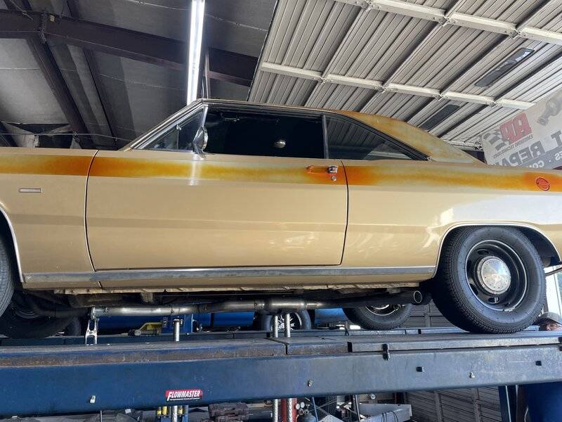

Photos of exhaust layout under car are much appreciated. That's a VERY nice setup.

Procharger cost was substantially more than the torque storm kit. I’ve found torque storm to have good customer service and they manufacture every kit to order here in America. I believe this is the only pic of the exhaust that I have, hangs a little lower than my liking, thinking about putting aar style mufflers on it as these dynomax race bullets are quite loud.

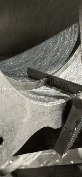

Evan, a few questions, did you add (or measure) ring gap? The two magnums I’ve measured had big ring gaps stock, like in the .028-.031 range. The one I just did was .030 across the board. What fuel are you running?
I’ll be interested to see what the torquestorm can do boost wise and very interested in the air temp testing if you can get accurate data. On a 350isn NA engine I’ve heard they struggle to make 8 or so, but then you see Steve Morris and his twin setup making north of 1000 on big cubic inches. Nice work and keep the thread going, please.
I have not opened this engine yet. Only pulled the intake and front timing cover to swap the cam. This magnum was swapped in this car during the late 90s. Wasn’t driven very often after the swap (not sure how many miles the engine has but it couldn’t be many).
