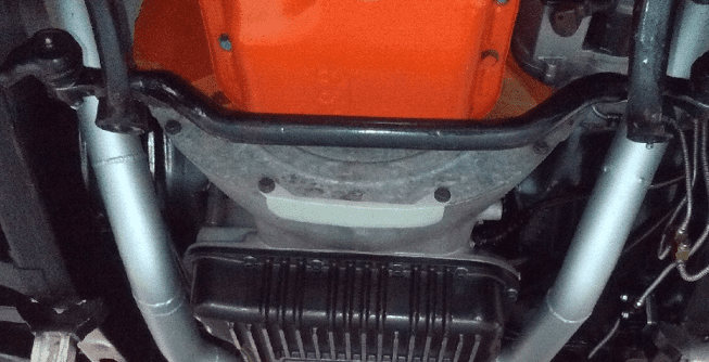

I ended up notching mine slightly in my BB 66 Dart then just made a little plate to cover it.

Nice photo. That's exactly the plate I was envisioning/trying to describe in my response to RustyRatRod above. Very clean. Did the notch in the bellhousing help at all?
Maybe slightly. I figured it didn't hurt anything - especially in my application. With the small cover I made, it's not going to let any dirt or any other road debris in. It may make draining the convertor slightly cleaner too I guess.
