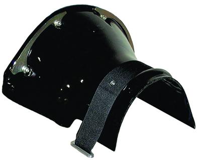

I’m reaching out for some help from the A-Body Community. It’s a long story but basically, I got placed on the waiting list for a replacement trans shield from CSR Performance in May. Still don’t have a part so I’m looking for alternatives. Any recommendations would be greatly appreciated. I’m running a 727 Torqueflite with big block in a 69 Dart.
Transmission blanket and a flywheel shield in the mean time. I'm still running the old school stuff like that.
I ran a blanket, work out the shift linkage and no other issues. Didn’t run warm etc. I truly believe they would do better in an explosion than the Kevlar/carbon shield. This really equates to body armor. The only “hard” item in body armor is ceramic plates (other than steel). So the best performing armor is ceramic plates with Kevlar fabric. You really don’t see a ridged Kevlar composite. Kevlar works because the fibers CAN move, but that’s just my 2 cents.
Also a plus, the blanket will soak up any possible leaks, short of an explosion. I use the flywheel shield as insurance just in case. The one time I had an explosion, the shield kept parts and pieces from penetrating the transmission tunnel.
I was on the waiting list for over a year for the CSR shield previously. Paid for and no sign of ever getting it. Cancelled my order and got a TCI shield that wouldn’t fit. Unfortunately, if you have a factory floor in the car, your options are limited. A blanket is ok, but I had to make tabs to hold it off the shifter cable and linkage. And got to be careful around the collectors . Not sure about a flex plate shield with the stock firewall and floor
I ran a blanket for a few years and it worked fine. (440 in a 75 duster) Had to make something to make it clear/stay off the cable linkage. I bought a CSR shield when they were readily available probably 10 years ago. Had to beat the firewall/floor pan lip flat and also drill holes to access the bell housing bolts and they are pretty much impossible to install from the engine bay side anymore. Also had to grind the one tab/ear off the transmission housing so the CSR shield fit.
Thank y'all for the feedback. I too have tried the TCI shield and couldn't make it fit. Fortunately I still have my old existing CSR shield.
I had to do the same as moparstud when I put the CSR shield on my small block / 904 Dart : flatten the lip and drill access holes in the firewall . I also had to grind the casting bosses off the bell housing in order for the shield to fit. ( picture is my spare 904 also with the bosses ground off )
