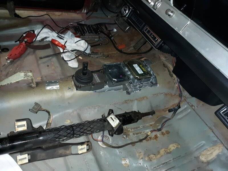

I bought a kit from silver sport transmissions with a TKO 5 speed. Kit had everything needed to convert to 5 speed from automatic.
this pic shows how far into the tunnel it went, I still had to build brace over trans, and tunnel cover.
