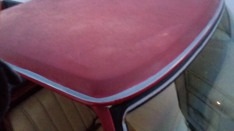

Where you show the picture of your roof is where mine is holey. Up away from the drip rail and you know as well as anybody how much the damage probably extends farther away than what is currently seen.... it always is

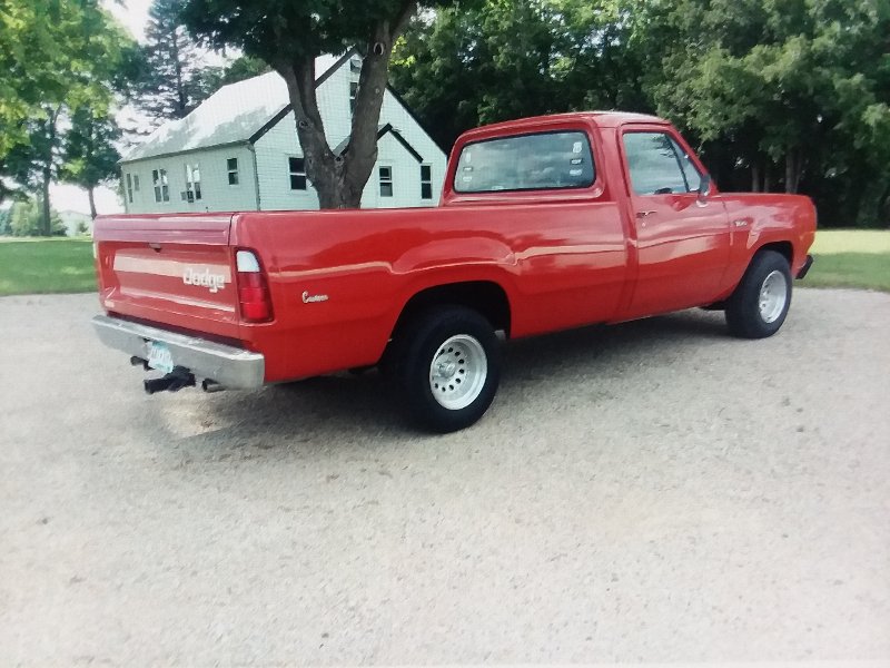

Things can rust in strange places. Had a '76 D100 with a nice clean body, but the roof seam had opened up and let water in. Rusted a 2" x 4" piece out of the driver's upper door frame > fixed that and sealed it back up. Those inside steel roof caps and steel headiliners had no primer on the inside of the parts, so when some moisture gets introduced it goes to rusting right now and doesn't drain out very easily. See a lot of the well used D-Series pickups with that front roof skin opened up cause water got in.
Also an old 85 year old farmer had the truck and never drove it to town, think he parked it under a lean to on his barn with the front end hanging out. That rusted the lower radiator mount supports out that mount to the frame, so I rebuilt and reinforced those. Did a V8 conversion to the truck from a slant 6. I had the whole front end off, so I painted all the parts inside and out to preserve them well. Even inside the super structure and the underside of the hood were painted back to the original color.
Box, tailgate and cab corners were perfect, and someone had done a nice re-upholstery job in black to the bench seat > liked that a lot.
Really liked that truck a lot as it was one of the best, simplest years for the non-computerized trucks.
So yeah it's always something to deal with on 40 year old vehicles. Got to commit and get her done. Got my efforts back out of it at the end when I sold it as it was a nice all around piece.
I liked that one so much that I have another rust free '89 D100 with the same 318 Automatic drive line > converted over to non-computer and a 4 barrel.

On my way home with it. Much better except for 1 spot along the top of the windshield underneath the rain gutter. And a solid unmolested back wall. Needs a little bit of floor repair in a different spot than the first cab I had (still have) but I have to cut the tunnel out of the first cab and put it in this one, which will take care of that at the same time
