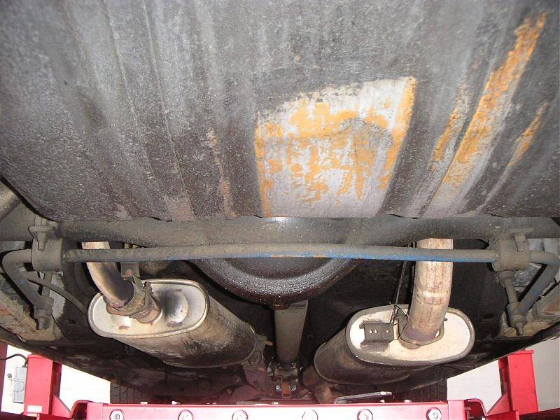

I finally got the car lifted and I took some pics of the installations! The last one is for 340mopar.
VK, where is the support/stiffener that goes from the K member to the radiator support???
Can't recall if it was stated, but these are the OLD design....the new ones that are out are MUCH BETTER design thanks to David Wheeler @ Hellwig who redesigned them.
