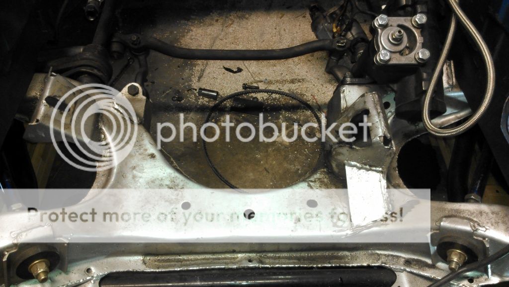

I bet yours is a slant k that ran BB conversion mounts. You slot the driver perch for the oil pump on a BB. If you want I can give a pic of mine when I get home.
They probably took the slant 6 perch on the K and moved it to the V8 position. I suppose it could still work, the oil pan fits the K when I put the motor in....
Here's what mine looks like:
Well I KNOW my K is a slant 6 K. I thought I remember that the SB and Slant K's shared the same pass side perch, the pics dont lie yours has a different pass side perch. So im guessing its the opposite, they share the same driver side and have different passenger side.
