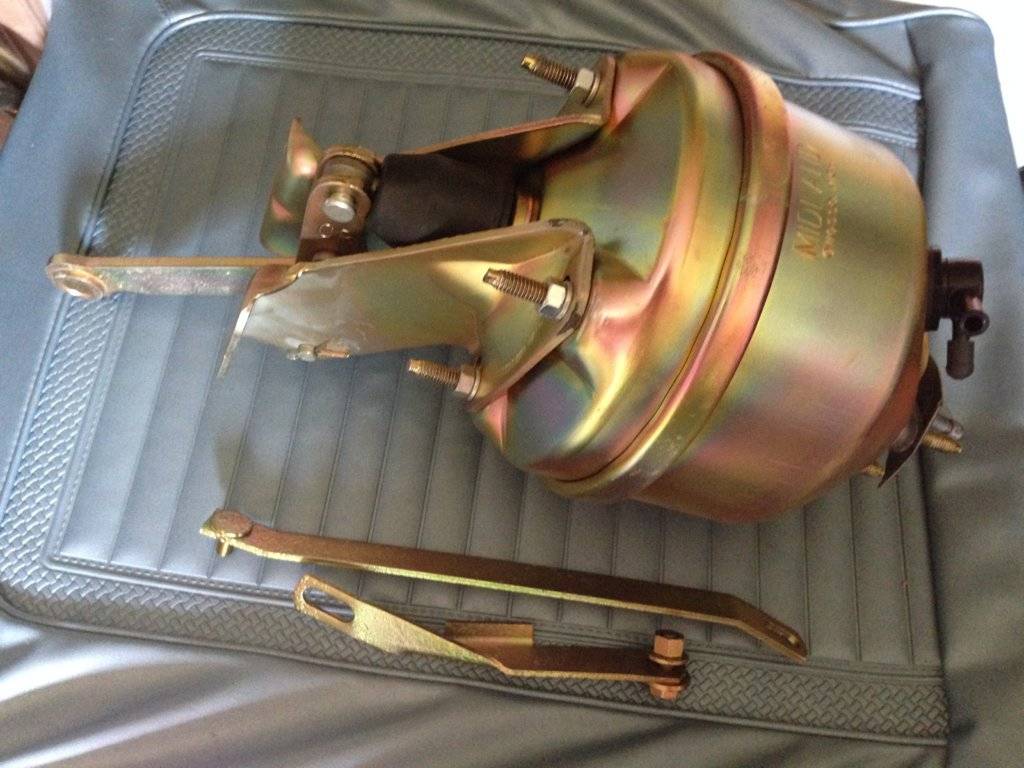

Pics would be good. Maybe with power brakes? I see a booster with an angled bracket that elevates the system offered online. Anybody tried that? Just would like to get an idea before I order the parts and then have to send them back, or worse yet, sit on them for a while. I know the early a does not have much room but only to shoehorn things in a limited space......therefore, the questions. Thanks again. Old Dart 66.
Jerry, If you use the Kelsey Hayes booster with the angled bracket, that will actually clear the valve cover. I will be using that set-up with the 273 in my wagon.
If you're using the original flat against the firewall 65 booster with the remote reservoir - I suspect probably not.

Loosing the booster in an early A, would not stop me from sticking a 340/360 in there. You can balance the brake system with hydraulic sizing, M/C bore sizing, and pedal ratios to get just what you want without the booster.
But the little booster shown works reasonably well, if you just gotta have a booster.
