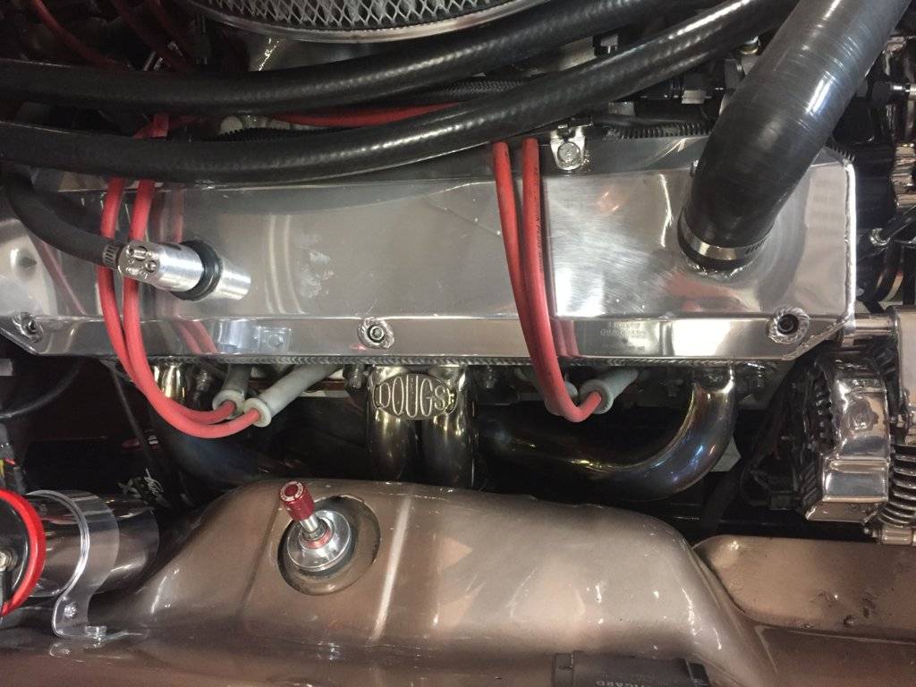

Thanks, looking forward to it. Clearance around the PS gear in particular if that photo would be available. Appreciate your time. Old Dart 66
No Problem, these are Dougs in a 1966 Barracuda, exactly the same as any 1965 abody. The steering box in the picture is the smaller Borgeson box but the stock box was in the car for 15 years before that box and no fitment issues with that at all. The finish on these is almost 20 years old, they are a quality product!
You bet on your help. Was considering TTI with their H exhaust. Yours look really nice. I still have time before I make a decision and I am ready to order. Great help....especially the photos. Much thanks. Old Dart 66
