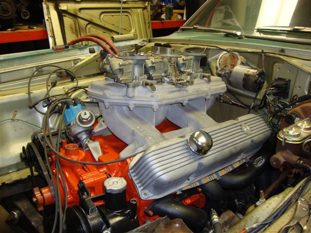

Go with a Weiand 1986 tunnel ram.
I have an early production one (no Weiand logo on the base) on my 12-1 383.
It has a single quad top, I'm doing that because I'm going to run a E85 Dominator.
Here's a mockup with a 750dp:
