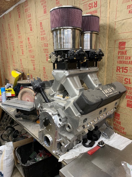

What’s up guys. Im starting my 572” build and am running a Indy tunnel ram with twin 1050 dominators. I can’t seem to find any info about plenum spacers…. I plan to build a 1-2” plenum spacer under my top plate. It’s my understanding that big cubes likes more plenum volume. Anyone see a downside? In all honesty my main reason besides a few HP is that I like the obnoxious look of a crazy tall engine hanging above the hood and I want a place to mount my single inlet, 4 outlet fuel pressure regulator in front of the intake without having to modify the intake. Let’s hear it boys. What do you think?
